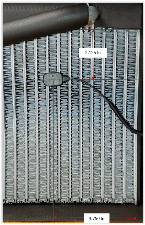

I listed the dims out earlier but decided to snap a pic of my core and put some dims on it to help you out quickly. Hopefully this will help.
Typically the temperature of the core operates ~ 10 degrees above freezing to avoid formation of ice crystals. So, when one encounters ice, there's three primary root causes involved and they are:
  1. lack of airflow over coil
  2. small leaks in evaporator
  3. low refrigerant level
