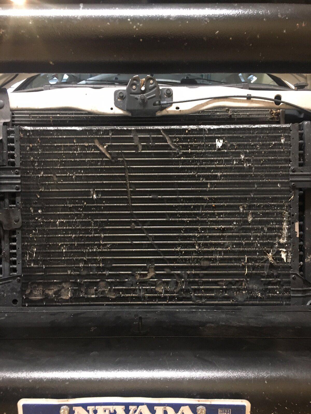

  2. I have attached a photo of the condenser. The entire top edge of the condenser fins are bent. Hood doesn't appear to be hitting the condenser so not sure what caused all fins to be bent. Tech said this was not good. There are other places where the condenser has damage but note that probably 85% of the font of the condenser is fine. I guess I'm questioning if the condenser really needs to be replaced?

Bent fins, unless a LOT of them are bent and you can’t comb them out, is no reason to replace a condenser. It would need to be replaced if the compressor has failed and there is trash in it or if it has a hole or leak in it.

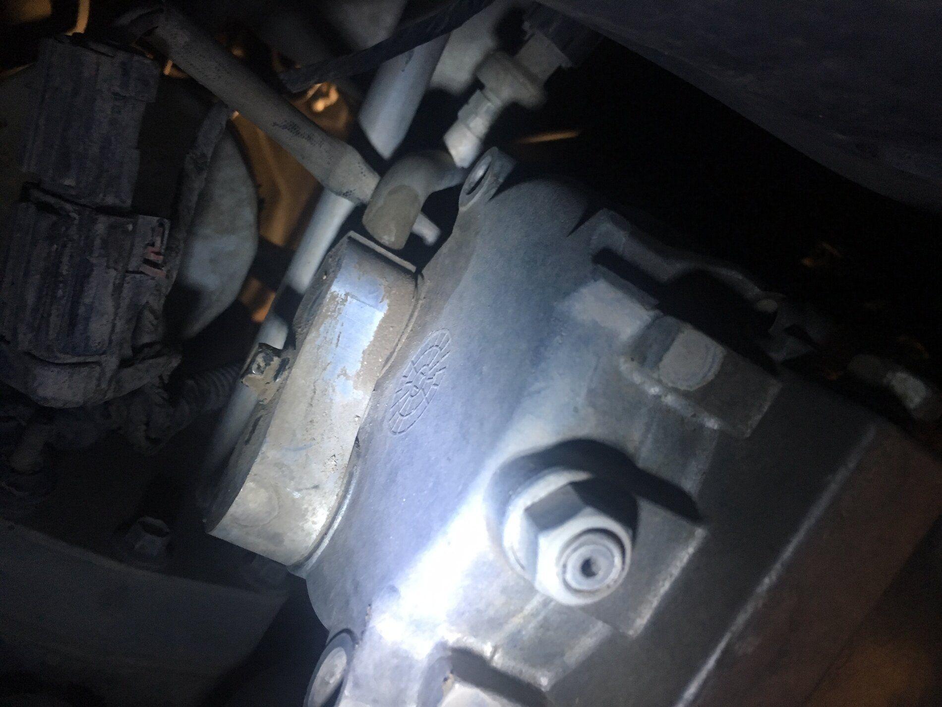

Nothing wrong with a Denso compressor.
Thanks for the response! When I noticed the green Freon on the garage floor I crawled under the truck and it was coming off the bottom of the compressor. See photo of the compressor where the dust has accumulated where the lines come into the compressor. The tech said it was leaking from the Shrader valves but I see only two valves, one at the air box and one on the accumulator (see photos), and no evidence of a leak there. I do see some dust accumulated on the line coming from the condenser (see photo but it's a little blurred). I don't see any current leaks probably because the compressor is not charging. I don't see any evidence of any leaks coming from the condenser. If I'm going to do this repair just want to get it all done at once and not have to revisit for awhile.

I suggest you replace the fan clutch with a new OEM Mopar fan clutch before replacing the condenser. (A picture of your condenser would help. Because if it's really "clogged" by bent over fins a good fan can't move air no matter what.) The AC system needs the fan working more than the engine does. Can I assume your fan clutch is over 5-6 years old? A lazy fan clutch that takes it's time to get up to speed causes extreme head pressures that can blow the system relief valve open and dump 1/2 the system charge, slip the compressor clutch esp. when kicking in when the head pressure is high, or blow seals. The hottest seal under the most pressure is the high side discharge hose washer off the compressor. If the compressor clutch slips long enough it opens a thermal fuse in the coil and the clutch coil is done. Any hotter and it can catch on fire thus the thermal fuse ... the fuse can save the belt and bearing so you can make it home if you are lucky. A failed compressor shaft seal can oil up the clutch and slip it as well.

Photo of the condenser with the bent fins is in my first post. What do you think? I can't figure what would have caused the bent fins other than the spray wash when I'm cleaning the grill. Bottom portion of condenser you can't see in the photo is perfect.
No debris on the radiator or intercooler or condenser. Mostly bugs. Truck gets used off road but gets a regular spray wash.

Ok so I need glasses and missed that. Looks like a normal condenser where a mechanic stood on the bumper and toes simply kick the fins. Spray wash can also do it. It doesn't look that bad. The condenser is the first "filter" in the AC system as it sees anything the compressor spits out first. Others has said how to check the AC system for debris to make the call to change it.
