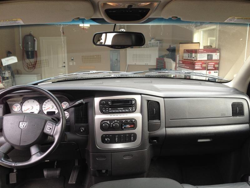

The dash has 2 fake rocker switch bumps between the heated seat switches as you can see in my photo. These were for the Power Wagon model and no switches are available from the dealer for this location. Do you have any pictures of exactly where your switches are located? That would be a big help.
Thanks.
The previous owner put this together, but he said that it was based off the heated seat switch plate that you currently have. My truck came with the factory cubby hole in that spot.
