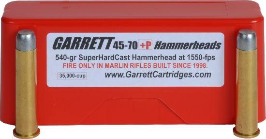

The two guns that Im taking with me on trips in the mountains against BEAR'S are with OPEN SIGHTS I DONT WANT TO BE LOCATING SOMETHING P O ed IN A SCOPE OF ANY KIND!!!!!!
The Marlin Guide Gun SS, 6 SHOT
540-gr SuperHardCast Hammerhead at 1550-fps
The Ruger SuperRedhawk 7. 5 in, 5 SHOT
330-gr SuperHardCast Long Hammerhead at 1400-fps
JMO , and many others up here
THESE ROUNDS ARE NOT FOR THE FAINT OF HART (RECOIL IN THE MARLIN IS VERY STIFF!!!! THE RECOIL IN THE 44 MAG IN IS NOT TO BE BELIEVED)
