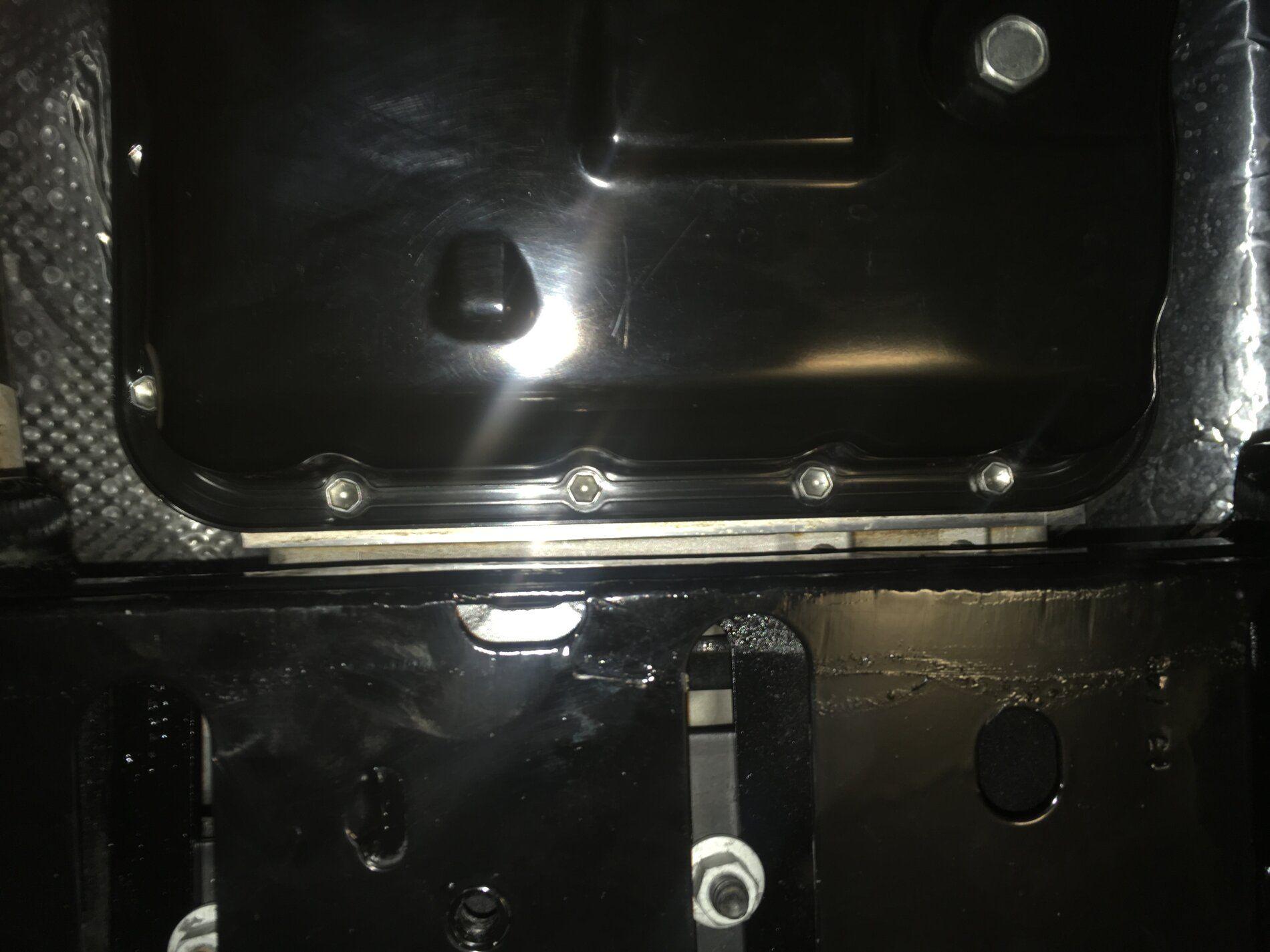

You’re missing the fact that Greg said others have been able to do the work without any crossmember interference. I believed what I read rather than investigating myself and lifted the trans without questioning why on my 1st filter change. After that I looked things over and realized it wasn’t necessary. Last 2 changes lying on my back in my driveway no jacking or crossmember interference. 1/4 drive, 10mil socket, 6, maybe 8 inch extension. Large diameter bucket.
I start them all by hand with the socket and extension.

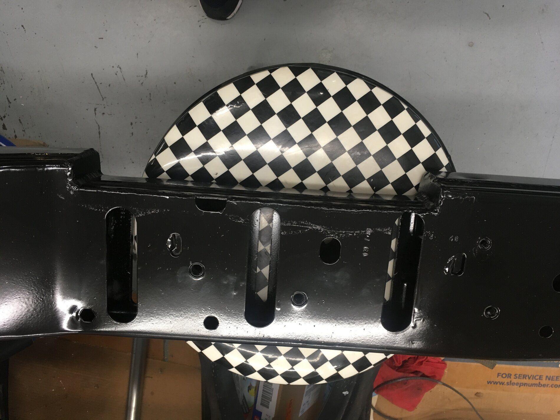

You can modify the crossmember and then its a snap! View attachment 114318
