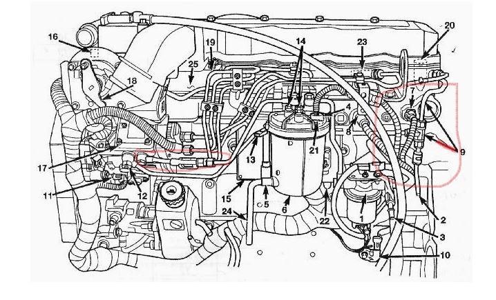

Look at this picture and does it look like your engine setup...note the areas circled in red.

Look at this picture and does it look like your engine setup...note the areas circled in red.View attachment 131852
I recently installed a MaxTow 0-30 psi fuel pressure gauge. See around 6-9 psi now with the lift pump relocation kit installed with the Carter pump P4601HP installed down on the frame rail just ahead of the tank. I have cleared up my losing prime issue by installing a checkvalve. Not where I mentioned earlier, instead I installed it, too down near the frame rail, just ahead of the pump someplace. I lost 1 psi by doing the checkvalve install but now she cranks right up like it should with no fuss, even if sitting for a few days. The relocation kit just so happened to have 2 JIC 06 hose barb fittings that were necessary for the install, H'mm maybe for this purpose?? Anyway pretty happy with it right now. By the way, the diagram seems close but the fuel filter canister seems to be slightly different on my truck.
