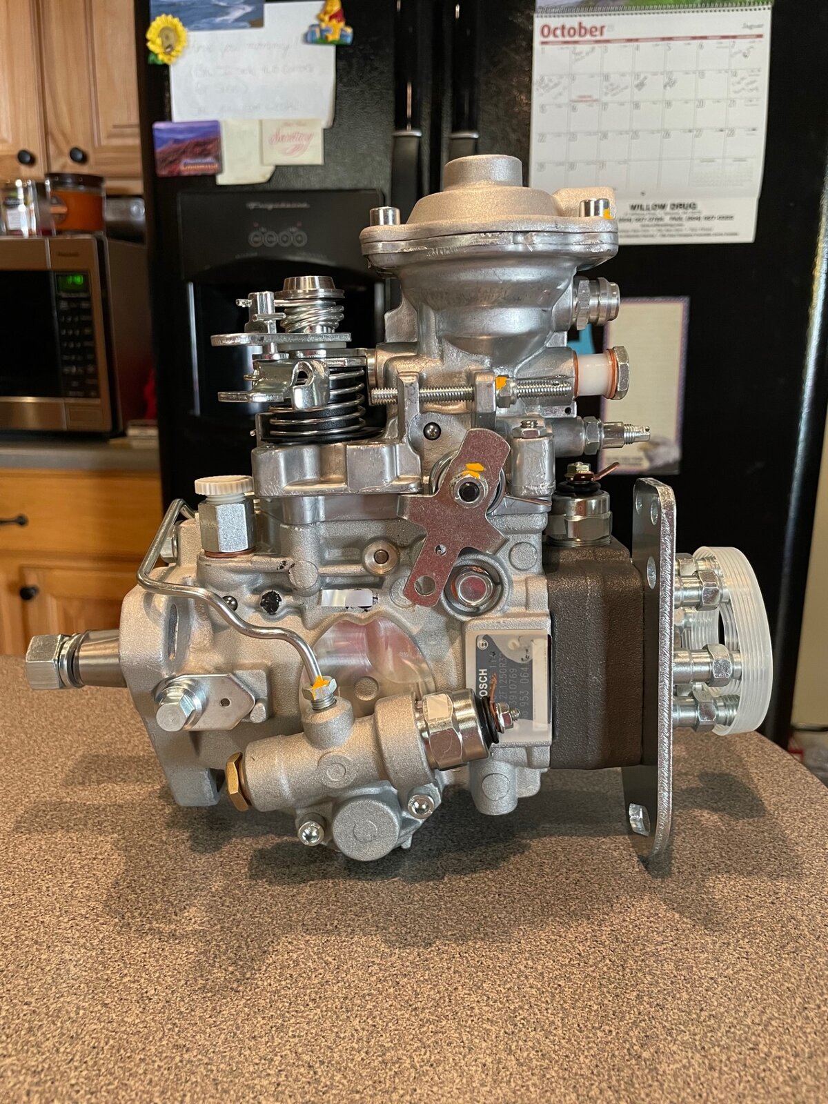

It has all the Bosch tags on it, so I'm assuming it is a genuine Bosch. It has no leaks that I've seen so far..
This is the pump. You can see the Bosch tag.
So..... parking it nose down didn't do anything for it. Is it losing prime????? I thought about unhooking the line above the T and putting a rubber hose on it, and putting the other end in a bucket of diesel.
Now, if it were a timing issue...like too much advance, then unplugging the KSB should help it, but it made it worse. It runs best with the KSB plugged in with key on power. As for the timing, I set it up on the "C" on the gear, instead of the "E", so it should have more advance than factory (10 degrees more). Being that the pump is a new Bosch, and not a reman or a generic, it should be good to go. This thing runs fantastic, once I get it started. I'm very pleased with the performance. I set the valves at .010" I and .020" E, so that should be fine. I've seen different specs on the exhaust valve lash. Some spec it at .026". Not sure if that would make enough difference or not. I don't see any leaks between the pump and the injectors. To bleed off there, it would have to leak fuel. As soon as I turn the key and run the FASS, it has 11 psi fuel, so I don't see the pump bleeding off. Any ideas from there???? I do appreciate all the ideas and input!!
