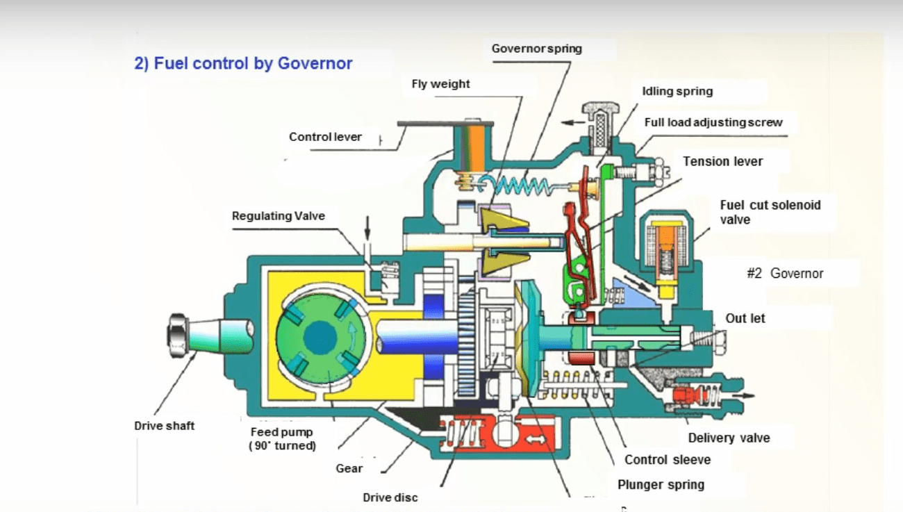

He’s not running a VP44, he’s running a VE pump.
I understand that he is running a VE pump. Instead of a constant pressure valve in each of the high pressure pump outlets, there is a delivery valve. I think the principle would be the same - how would fuel drain back?

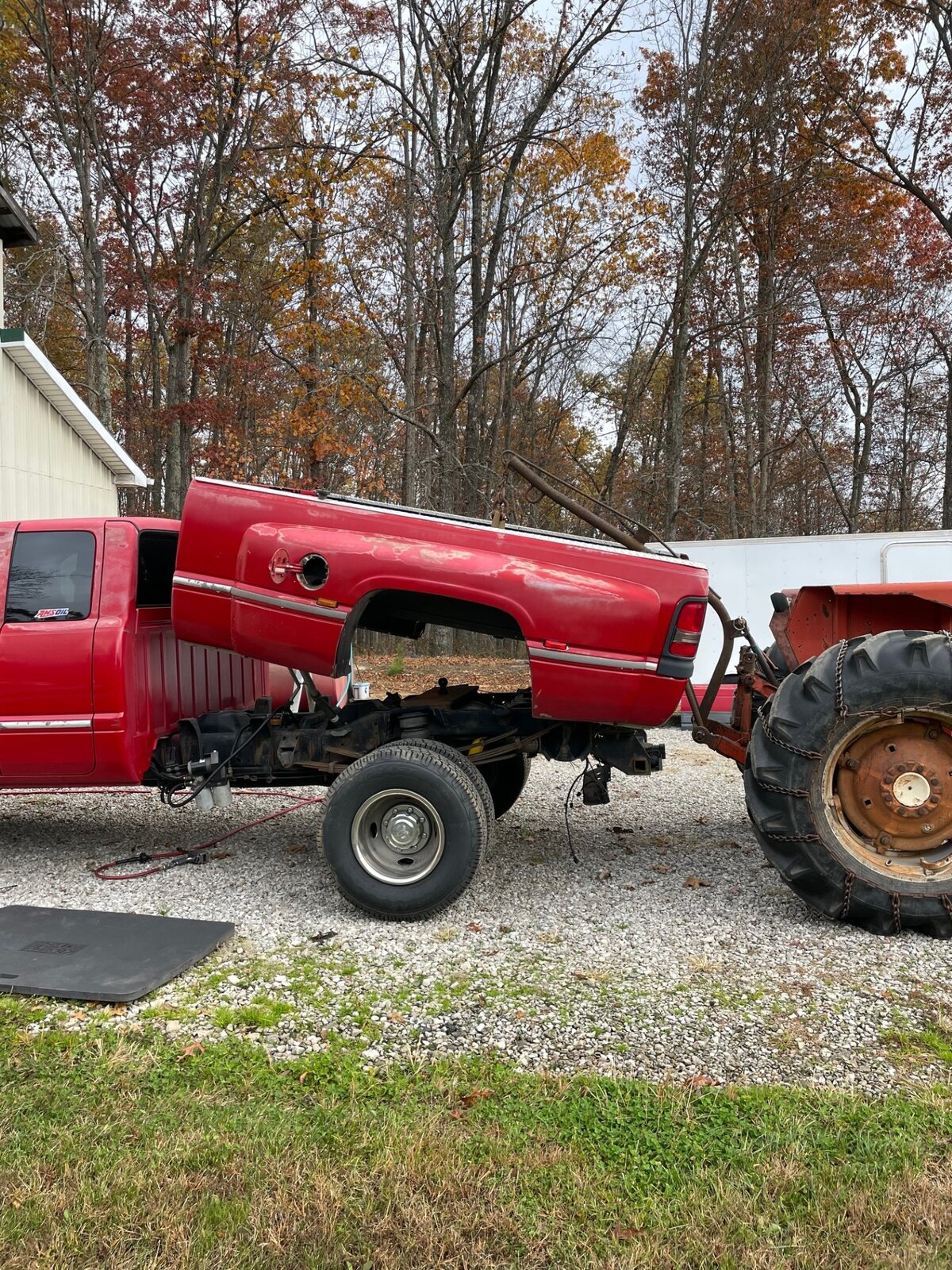

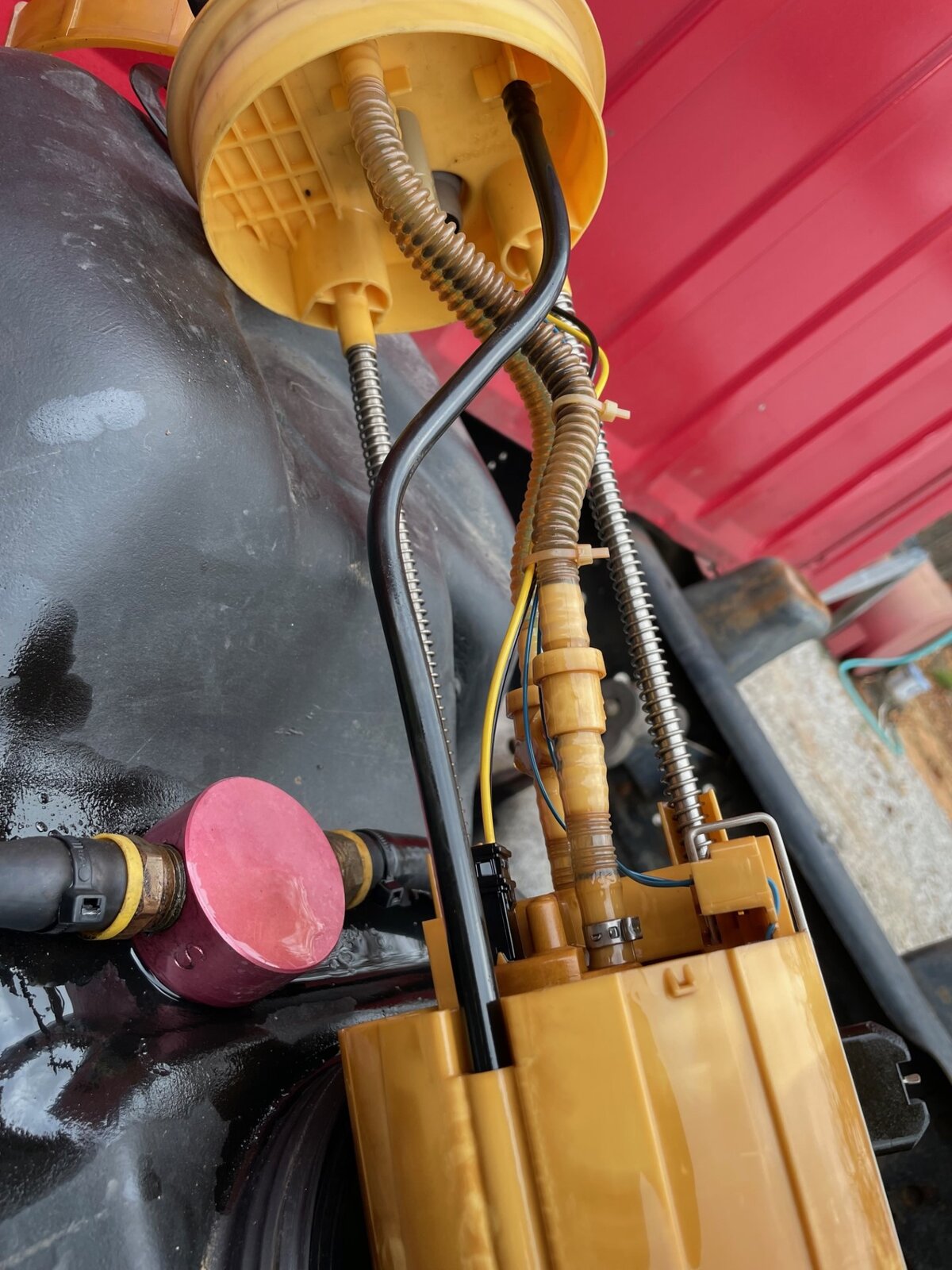

OK........ so the bed is off. Took me about 45 minutes to pull it with the help of a tractor, pig pole, and a home made bed puller. I pulled the fuel canister out of the tank, and the port that I'm using also has a tube (black in the picture) going to the bottom of the tank. Everything looks good, but I can see that the original port goes into a valve or crossover of some sort, connected to the fuel supply line for the original in-tank pump. I'm wondering if the "valve" has some sort of purpose in this?? I'll include some pictures of it, and if anyone has any suggestions, I'm all ears. I don't see an issue at the tank. I even considered separating the return from the VE pump and the return from the injectors, and running a new line from the tank to the back of the head. OR...... hook the original clear/yellow line from that valve to the port that I'm actually using. Your thoughts? I'm scratching at straws at the moment.
There was no in-tank pump, it was on the side of the engine. All that was in the tank was what you have.
Explain again how you have the FASS plumbed, please. I recall you said something about not using the return line. If you bump the starter and let the FASS run a couple of cycles, does it start?

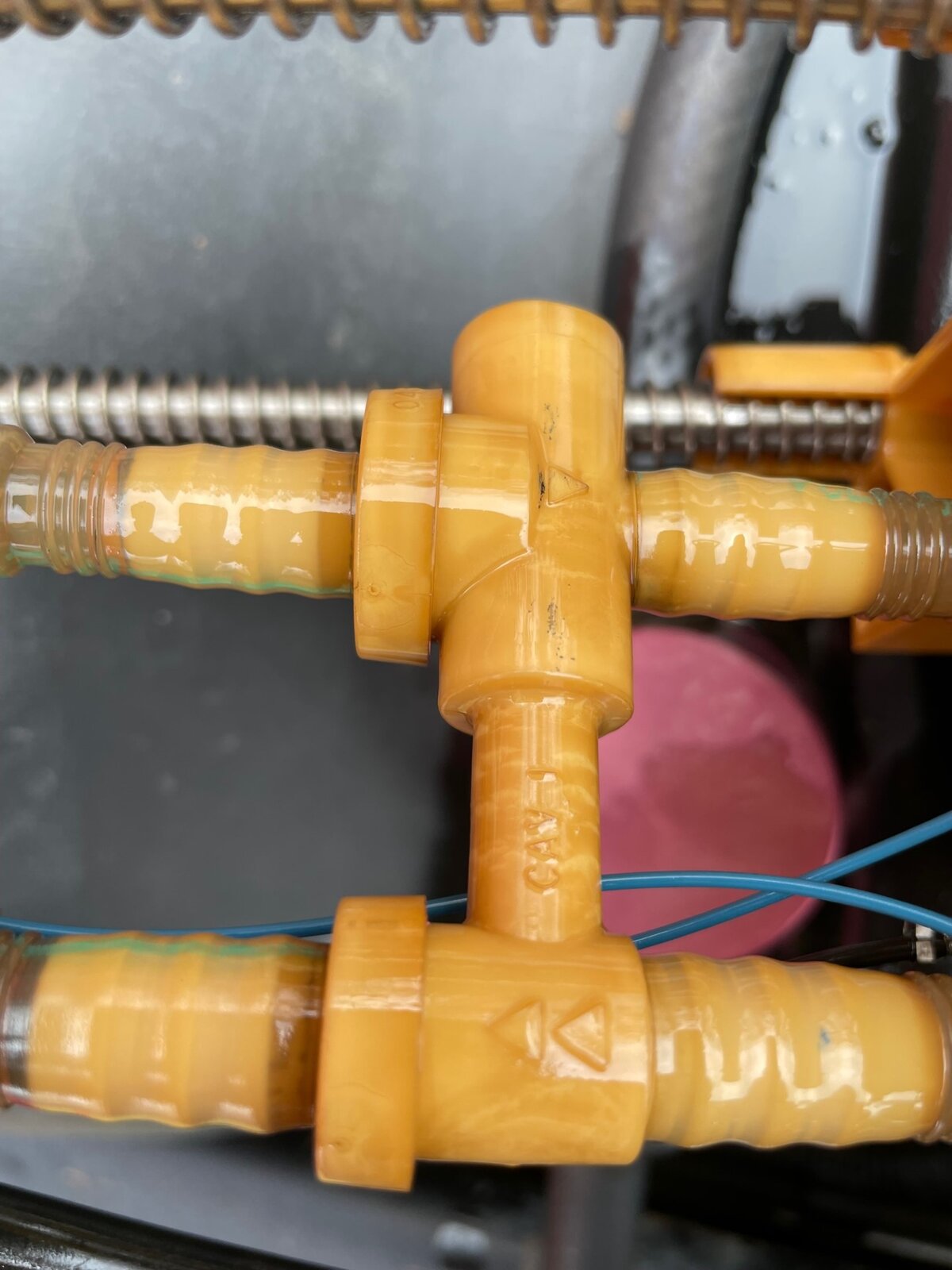

If you look at the picture, the yellow pieces have arrows on them. One in and one out, and below those wires is an electric fuel pump...... approximately 2" in diameter. First one like it I've ever seen. Could this have been off a gas truck???

I did a little reading. (ok... a lot of reading), and there were some with in tank pumps.
There were no 2nd Gen diesels with in-tank lift pumps. The 12-valves used a mechanical piston pump in the side of the block above the starter and the 24-valves had an electric pump mounted on a block-off plate in the same location.
I just found a couple articles on Diesel Bombers and also on Cummins Forum that said some 2nd gens had the in tank pump. These were a Carter in-tank lift pump. One article said that the in-tank pumps were retrofitted at the dealer per TSB.

Mine definitely has one.

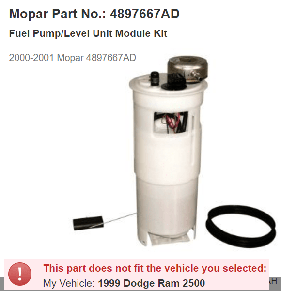

Yes, the first link is an in tank pump module, second link is the module with fuel level only.
https://www.moparpartsgiant.com/parts/mopar-modul-kit-fuel-pump-level-unit~4897667ad.html
https://www.moparpartsgiant.com/parts/mopar-modul-kit-level-unit~4897668ae.html
That part in the first link certainly doesn't look like what you have in your pics.
There should be documentation if your truck was retrofitted. Why would it have both in-tank and a FASS?
