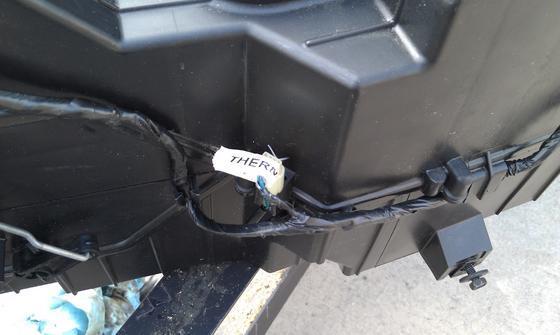

I went through this exact same senario with my '03 3500.
Freezing evap. especially on high humidity days. NO air flow until it thawed.
relocated the probe in the evap... ..... problem solved.
