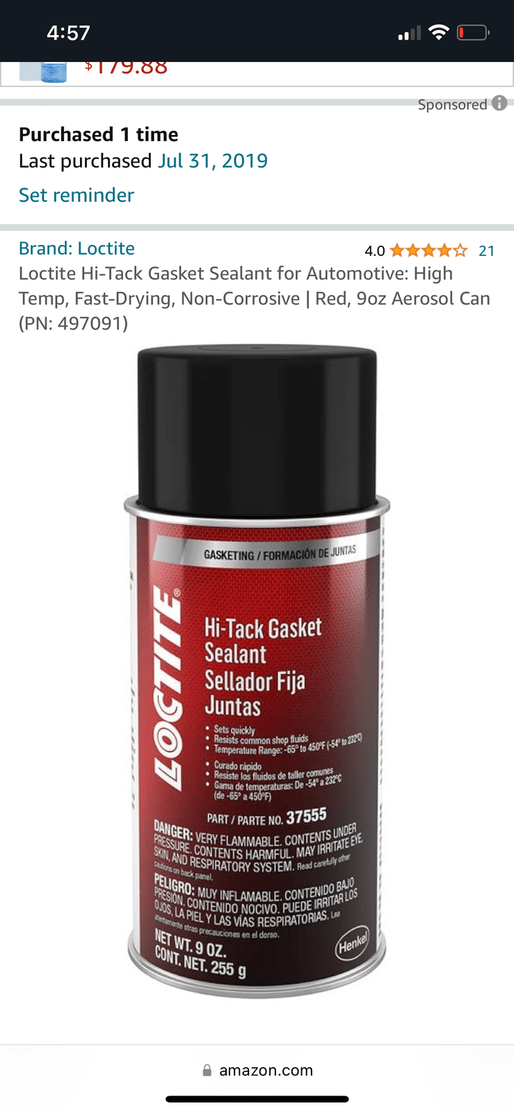

The spray adhesive GS turned me on to holding gasket to the pan is a BIGGIE. Also grinding down a six pt 10mm socket using a 1/4 “ flex extension makes the hard to get at bolts nearly a breeze.

What was the spray adhesive that you used on the pan gasket?
Here ya go.
