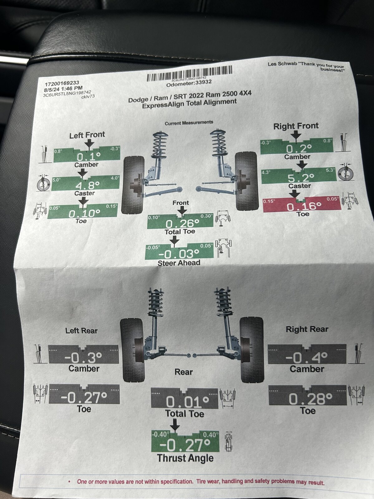

View attachment 141380 View attachment 141379 22 2500 mega cab. While driving down the highway I have to hold the steering wheel to the left. If I make the wheel strait the truck pulls to the right. Figure it needed an alignment. Took to Les Schwab who brought me back and showed me the truck. Front alignment was in spec. Said however my real axle is not strait. They provided me the spec sheet with all their measurements. Has anyone seen this or had it happen? Wanting to know a cause or if anyone else has a spec sheet with their numbers. Spec sheet attached.

It looks like one side is forward compared to the other. It’s still under warranty at 34k miles. Took it to the dealer this morning. Just find it odd. Went camping over the weekend and while sliding my fifth wheel hitch I had my wife bs k the truck up while I held the handle and when she put it in reverse and it loaded the axle it looked like it moved forward.

So did Les Schwab just check the alignment for you or did they "align" it? Because the toe is still not correct. That does not change the thrust angle, but if they charged for an alignment they didn't set it correctly. And according to their specs, the thrust angle is within specifications, factory spec is 0° +- 0.4°..
They checked and said it was in spec enough not to do it and suggested a bigger issue. I did just get it back from the dealer who did an alignment and got it strait. Everything seems to be fine now? So not sure as the dealer didn’t give me any sort of print out of the alignment before and after. But it drives strait.
