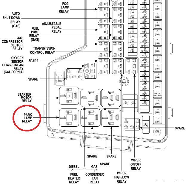

Looks like you have a relay that controls the Parking Lamps. Swap it with another of the relays that you know works and see if they work then.
