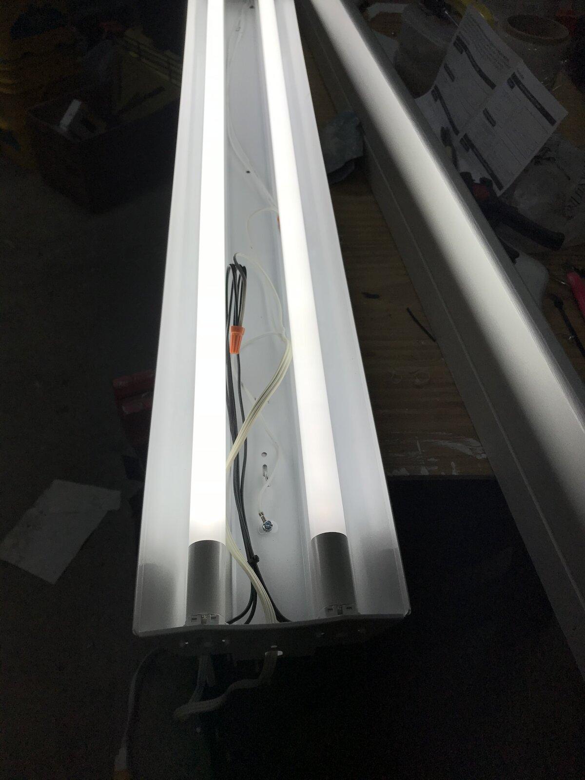

When I deleted my ballasts I was able to reuse the tombstones and pull about 5' of wire out of each 4 bulb fixture as I rewired them.
Works great!!
First light test after rewiring. These bulbs don’t care which way the tombstones are wired. Have instructions for either scenario..
