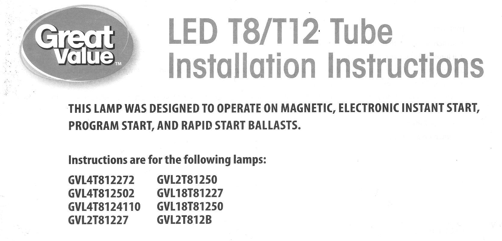

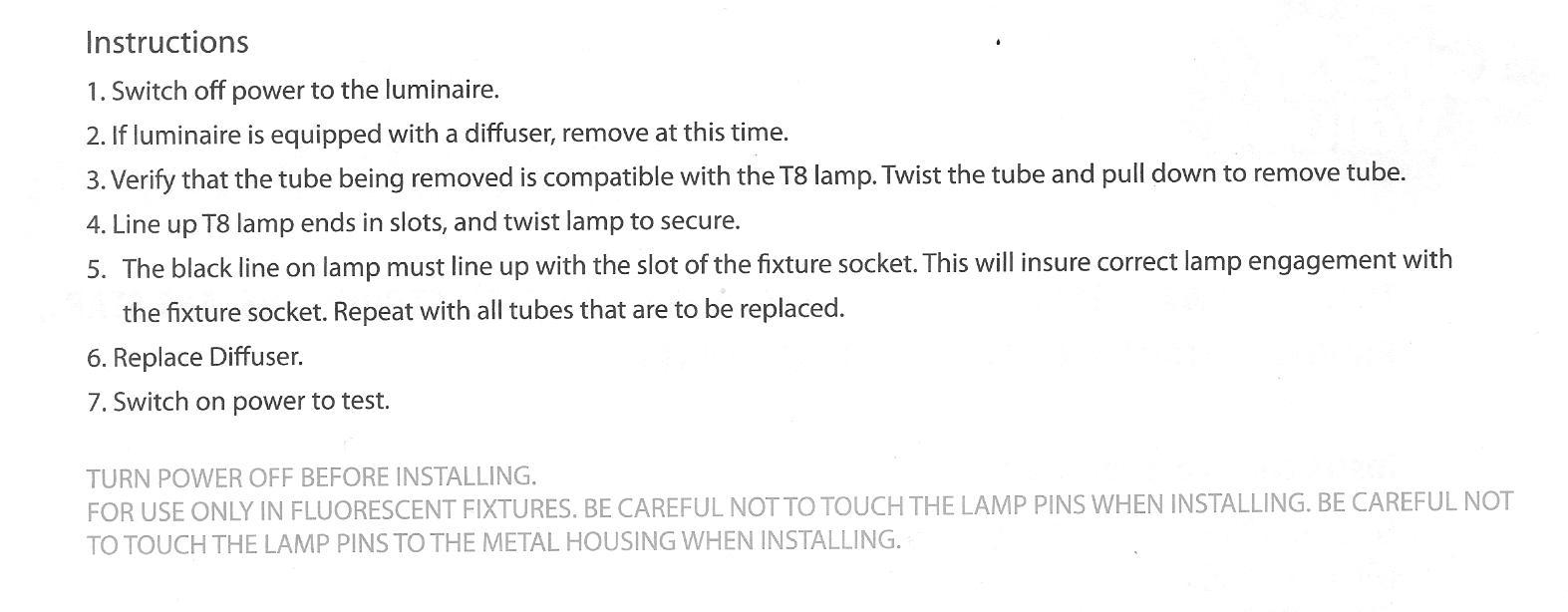

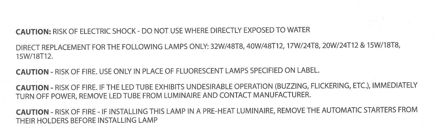

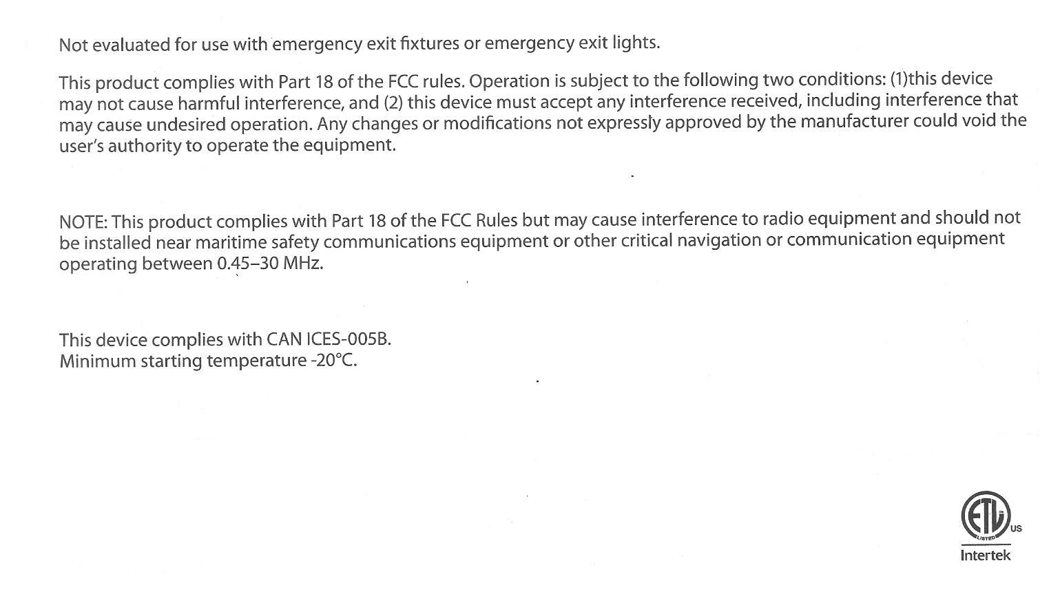

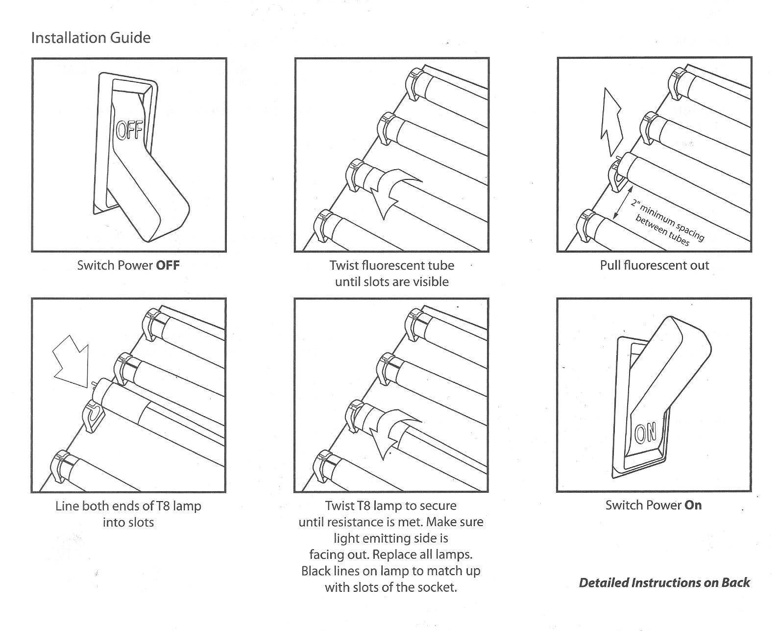

Here's the instruction sheet- note the heading regarding ballasts:

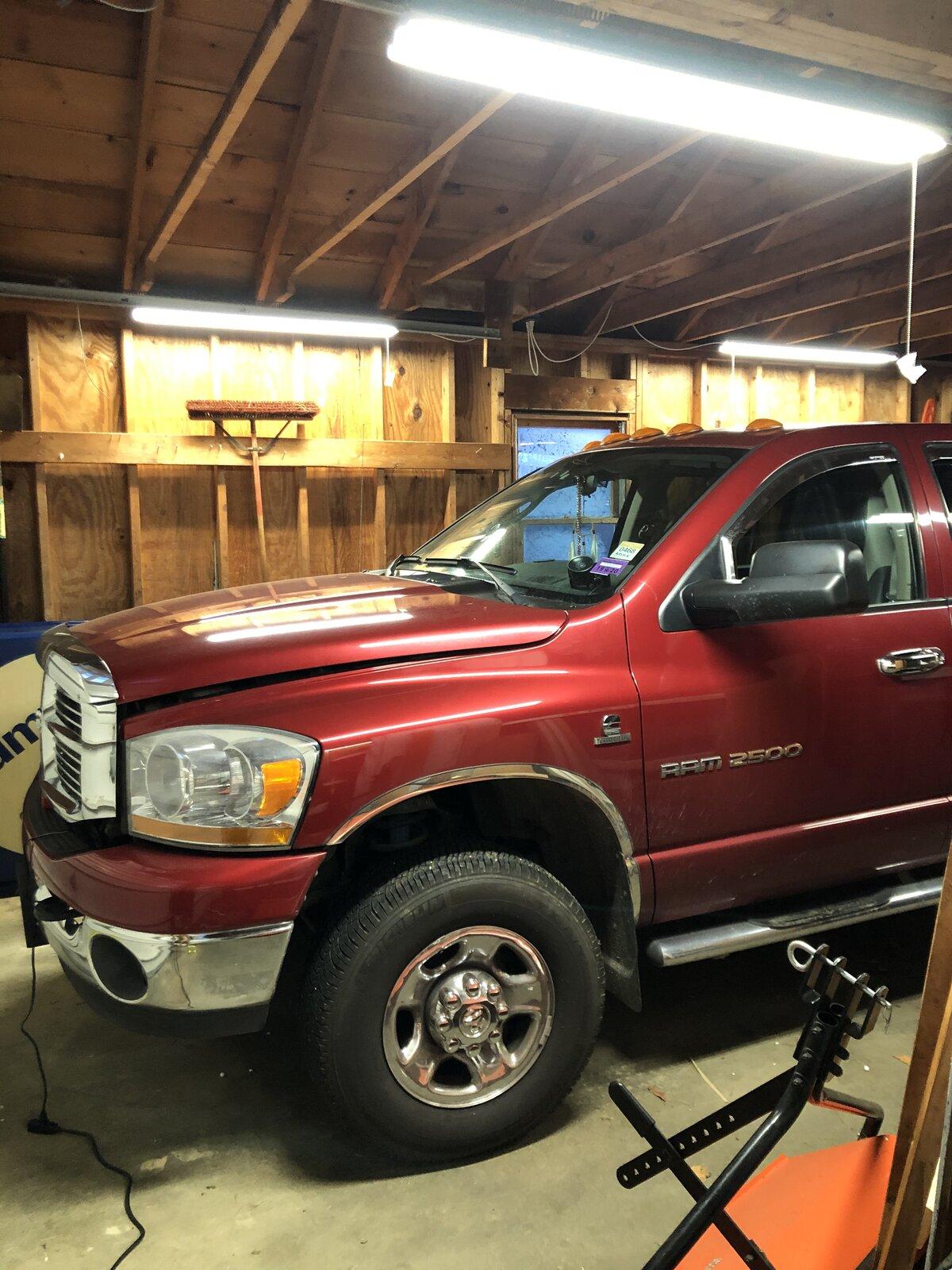

Also, I have found that, when replacing tubes in a 4-tube fixture, I only needed to put 2 LED tubes in- they're bright enough that putting all 4 in wasn't needed.
I don’t think you can have too much light in a shop/garage. I was going to put my lights on 2 switches and am glad I didn’t waste the wiring. 4 4 row fixtures at 8800 lumens a fixture is pretty good for the 20x36 bay they are in. The lights are at 18’ and my insulation is very reflective.
Mike, now that you have had the lights for a while what's the opinion, cold weather operation ?.

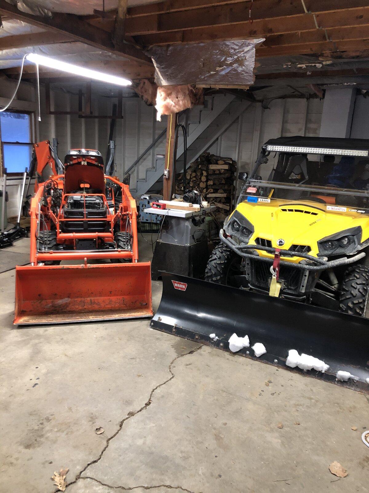

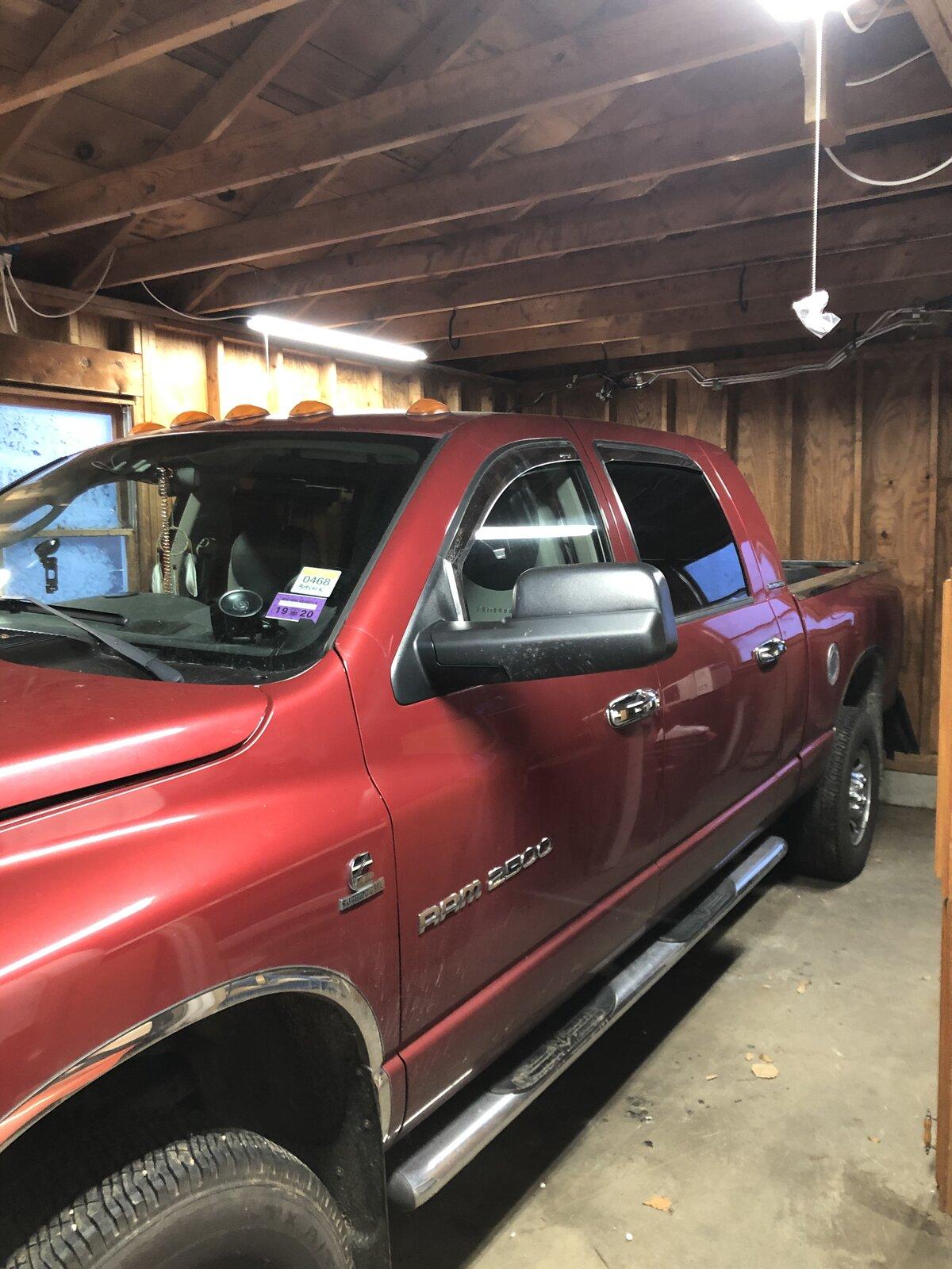

Temperature does not affect them at all, I have these replacement tubes in my small heated garage at the house and even at 45 degrees they fire up at full brightness right out of the gate. The previous standard tubes would flicker at those temps.
Down at the two unheated garages the LED units I installed do the same, instant full brightness no matter what the temperature. The LED's are the way to go....
