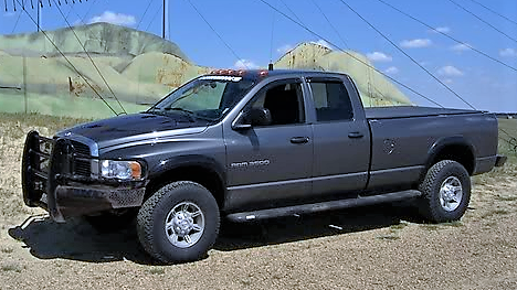

I've always liked the Hummer H2 rims. I've bought a few sets for very cheap, back when new take-offs were plentiful. The local welding shop soda blasted them and powdercoated them pretty reasonably. I've got photos of them black, but they're sort of hard to see. This one set had nearly new tires still on them.
NOTE: You do need to open the center bore a bit to get them to fit. Ram center caps also require some modification.

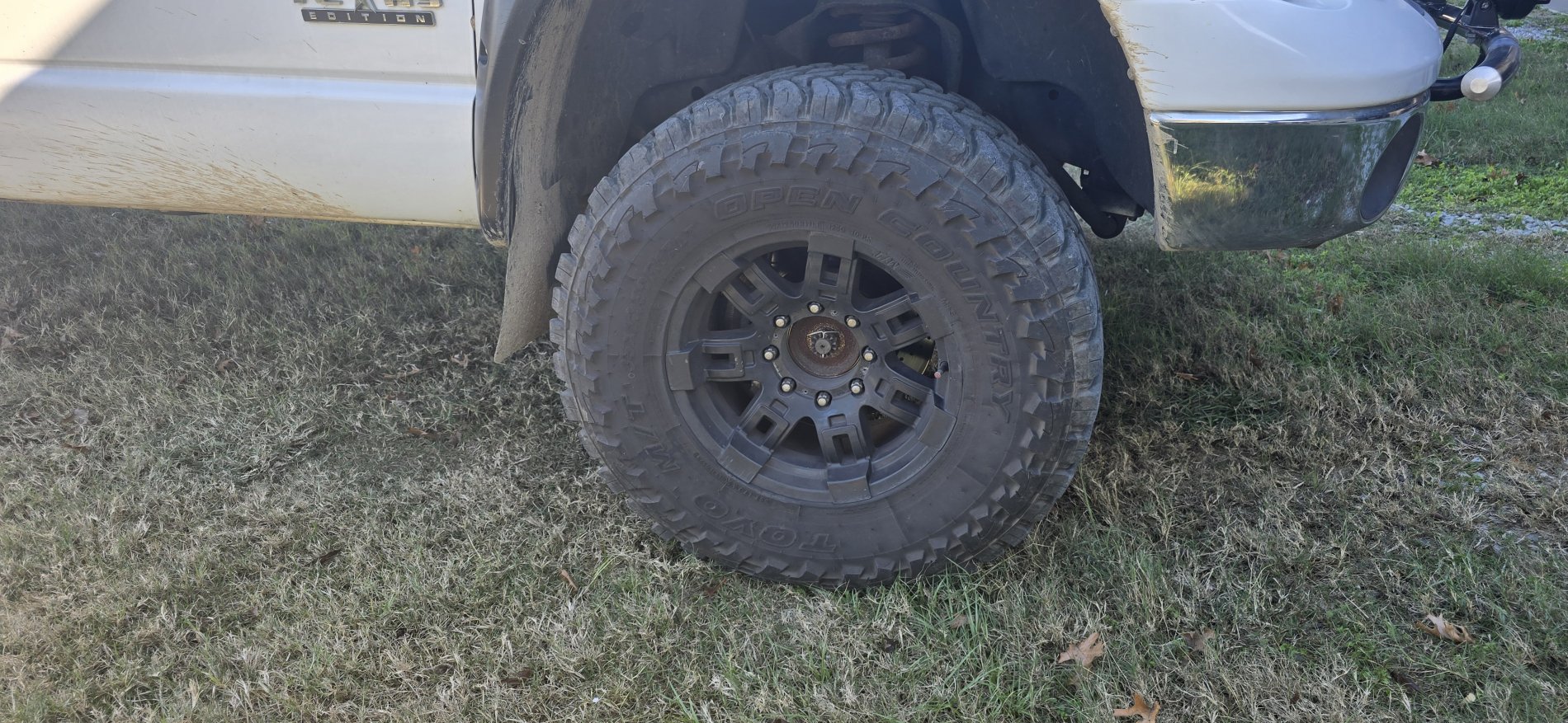

I am running Mickey Thompson Rims SideBiter II 17". But they are not available anymore, the rims were rated for a higher load carrying ability then now. They were bought in 2015, still look like new. They are not used in the winter/snowy months stored in the garage and the stock rim and tires are used in the winter months.
They do offer a newer model called MT Canyon Pro Satin Black in 17-18-20, inches with a good load carrying ability. I would order these today if I had to replace my current Mickey Thompson rims.
My tires that I am using with the Mickey Thompson rims is Nitto Dura Grappler LT285/70R/17 126R tires.

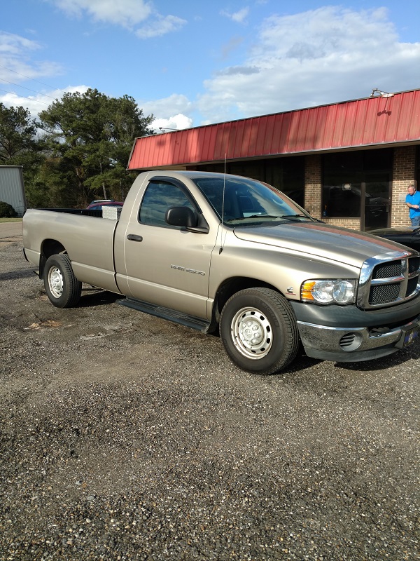

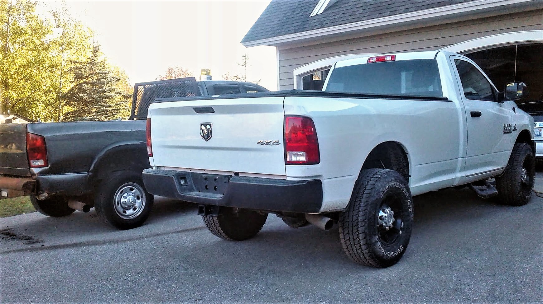

Personally, I like the stock rims. My truck had the steel tradesman rims. I found a set of 2008 takeoffs with 40K original miles on it, the guy was going all blackout and so I bought his OEM wheels. Proper offset and all, caps and lugnuts, it was $400 for the 4 in 2018. Shaved 17 lbs each off the weight of each of the tire/wheel assys going to the alloy wheels. I could feel the difference when hitting bumps.
