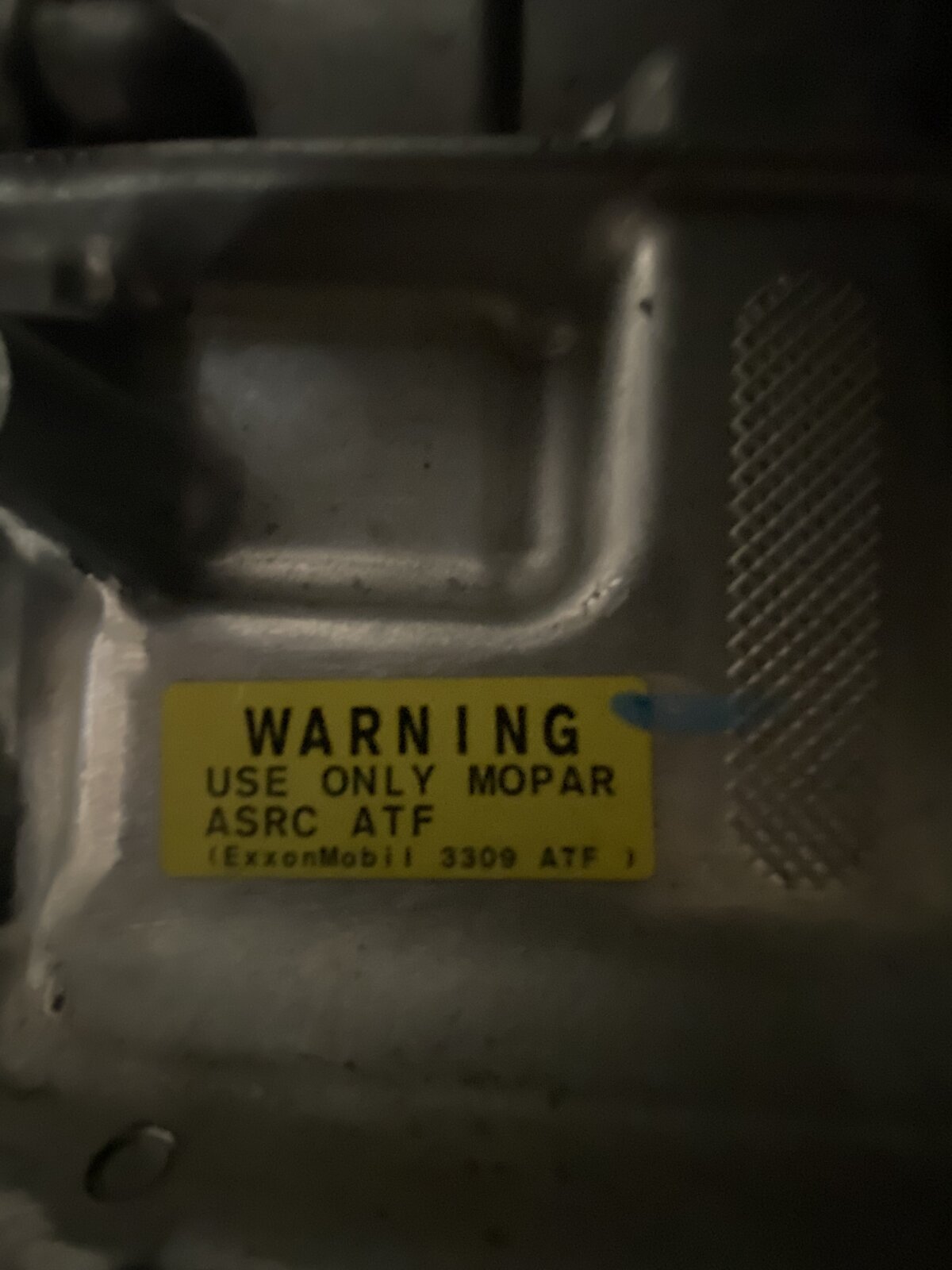

I just climbed under the truck and my label say’s WARNING use ONLY Mopar ASRC fluid!
damnit, I have an 8 year warranty and don’t want to risk it so I bought 3 gallons of the ASRC.
don’t know what I’m going to do with the Mobil stuff. Maybe ebay
Well I was finally able to get a good look at the tag
couldn’t see it because the rear seat floor storage compartment blocked it from view.
finally got a photo of the tag and 3309 is mentioned specifically!

ASRC = Mobil 3309 = JWS3309 = Toyota T-IV = Aisin ATF-0T4
There is nothing special about the fluid, it’s just hard to find because most transmissions that used it stopped using it around 20 years ago. It’s an old non-synthetic fluid spec, and the main reason the service intervals are so short.

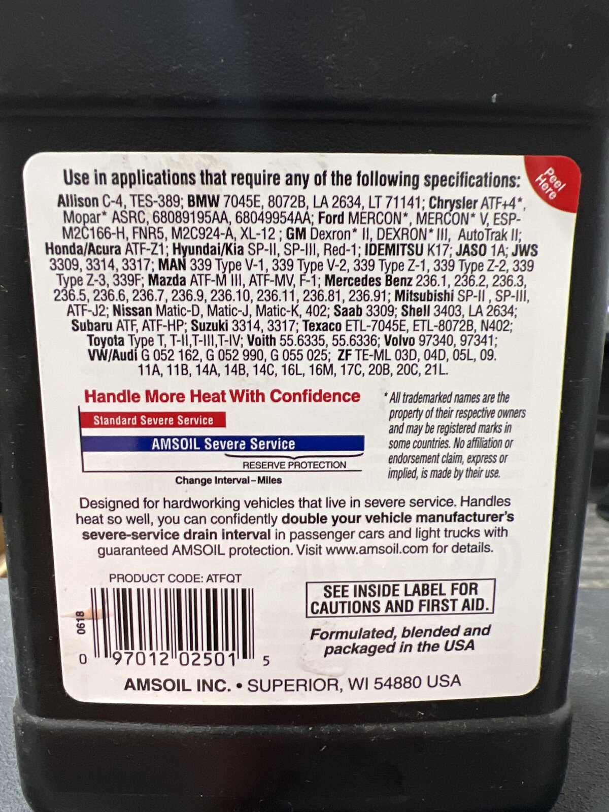

I have a REMAN AISIN in my truck by showing documentation of both AMZ/OIL and MOPAR fluids along with AISIN filter. The reman has nothing to do with the fluid used. In fact the reman has 100% AMZ/OIL in it from when it was installed one year ago.
If Chrysler didn't feel AMZ/OIL was ok to use they sure would have tried to deny warranty replacement.
now if they offer a synthetic that will keep my warranty intact, I might try it.
ASRC is printed on the Amsoil bottle (as is JWS3309 and other 3309 equivalents)… so there is your synthetic that will keep your warranty intact. I also have the Mopar 8 year warranty and have zero thoughts that Amsoil ATF will void my warranty, or cause a claim to be denied.

ASRC is simply a fluid spec, as is 3309 of which Mobil happens to make one. This discussion hasn’t strayed from those spec’d fluids, so hardly a hornets nest.
