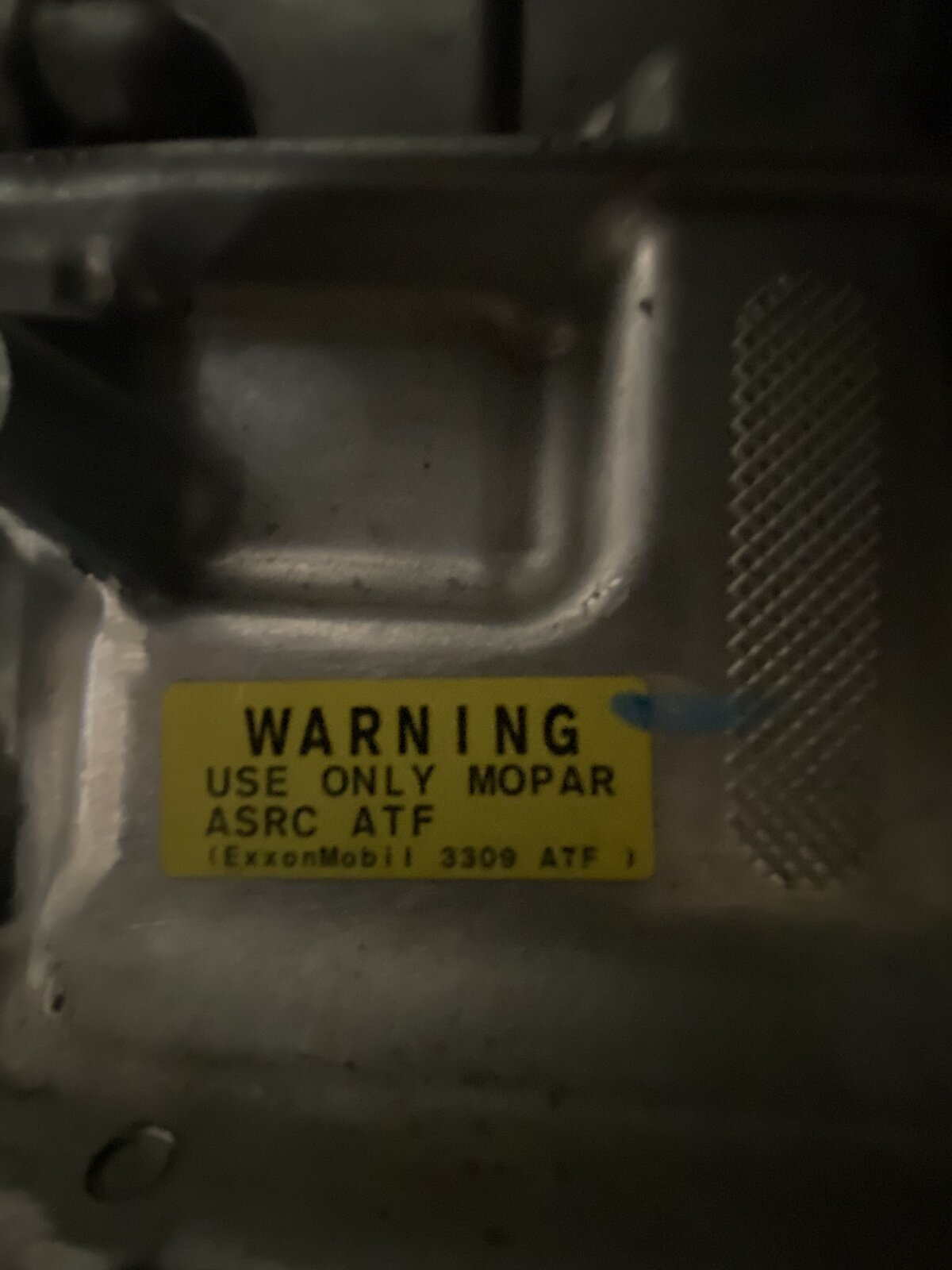

AS68RC fluid vs Mobil 3309

This whole thread was asking about possible differences between AS68RS and Mobile 3309.

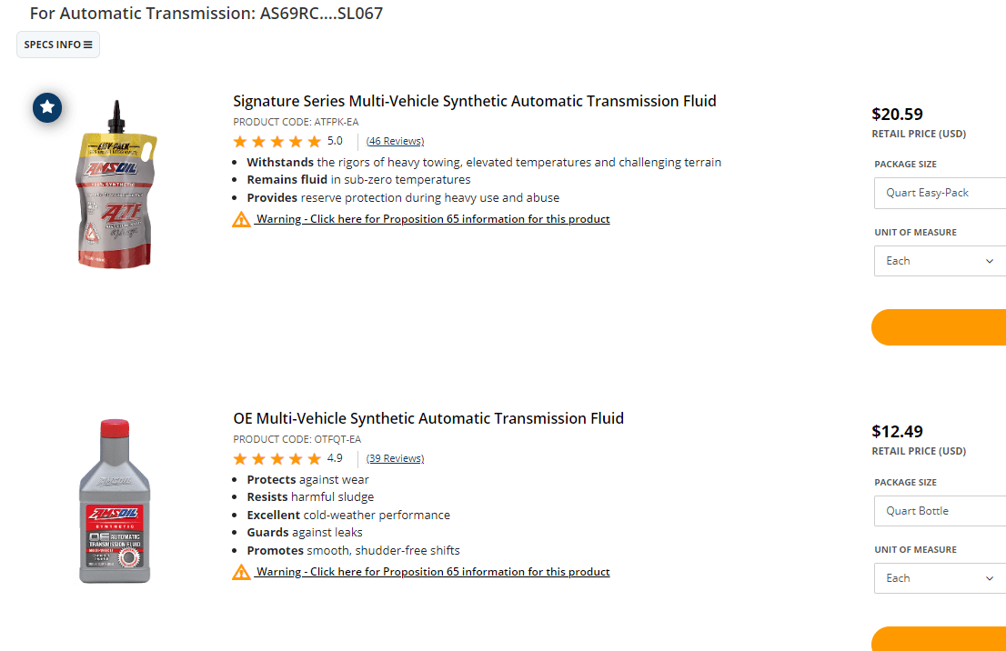

So going to order my Amsoil for my 30K service as I need to go it prior to a trip to WV end of OCT. I have some ATF on the shelf from my previous 04 since, but was curious since on the webpage they are showing only 2 options. One is OE ATF and the other Signature ATF. Without doing a ton of research on it what are you all using in the AISIN? I will likely buy a case (or two) since it is also spec'd for the T case and PS. Side question, I changed my diff oil also (dumped the factory fill) at 10k and put in severe gear, I was considering doing the rear axle but not the front since I rarely use 4wd, but do need to keep up with that 8/125 warranty.:cool:

I use the Signature Series.
Not that it affects is, but the OE doesn’t meet the requirements for Chrysler ATF +4.

I also use the signature series but pay a bit less than that.
