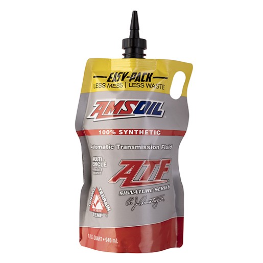

So I’m ready to make a Amsoil order. Signature series synthetic atf comes in multi vechicle or fuel efficient . Which one do I want and what’s the difference
Looked up your truck. Use in your transfer case also.
For Automatic Transmission: AS69RC
Signature Series Multi-Vehicle Synthetic Automatic Transmission Fluid
PRODUCT CODE: ATFPK-EA
