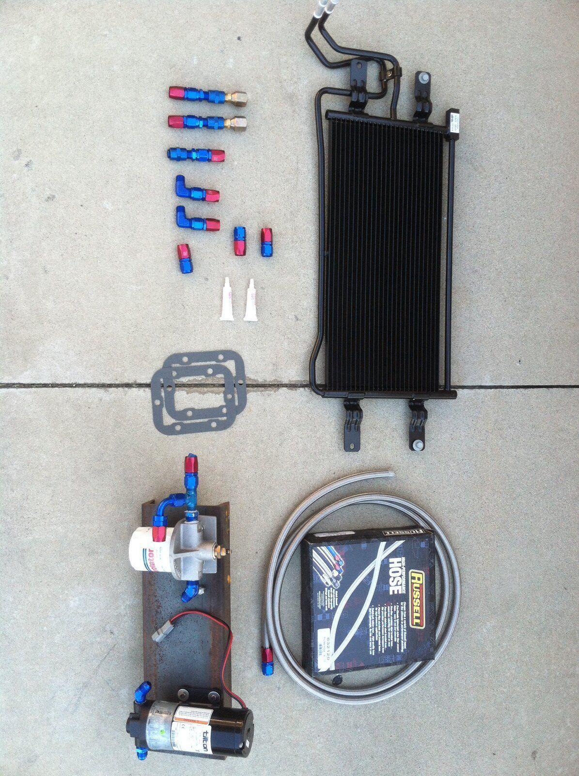

I set up a cooler for my G56, as it has gotten up to 250* at only 15K GCW. The heat exchanger is the OEM auto trans cooler, that fits both manual and auto equiped trucks on the radiator. The bypass is still active, and I plan to leave it that way. I manually run a pump, when the G56 gets up to 180*, cooling it down to 160*, so the bypass is not necessary.
