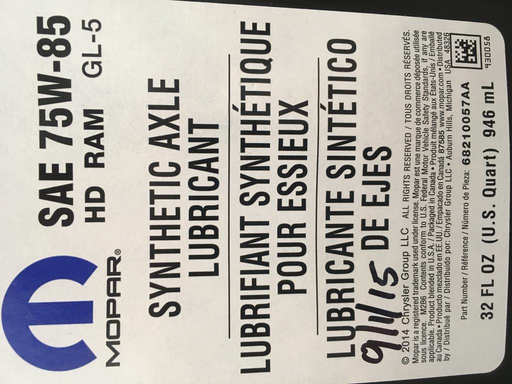

I guess I'll keep running the good ol' Valvoline SynPower 75W90 GL5 Full Synthetic. It looks like the 75W85 is used in some applications as transmission fluid.

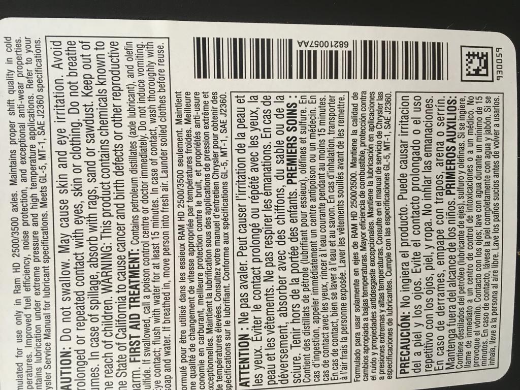

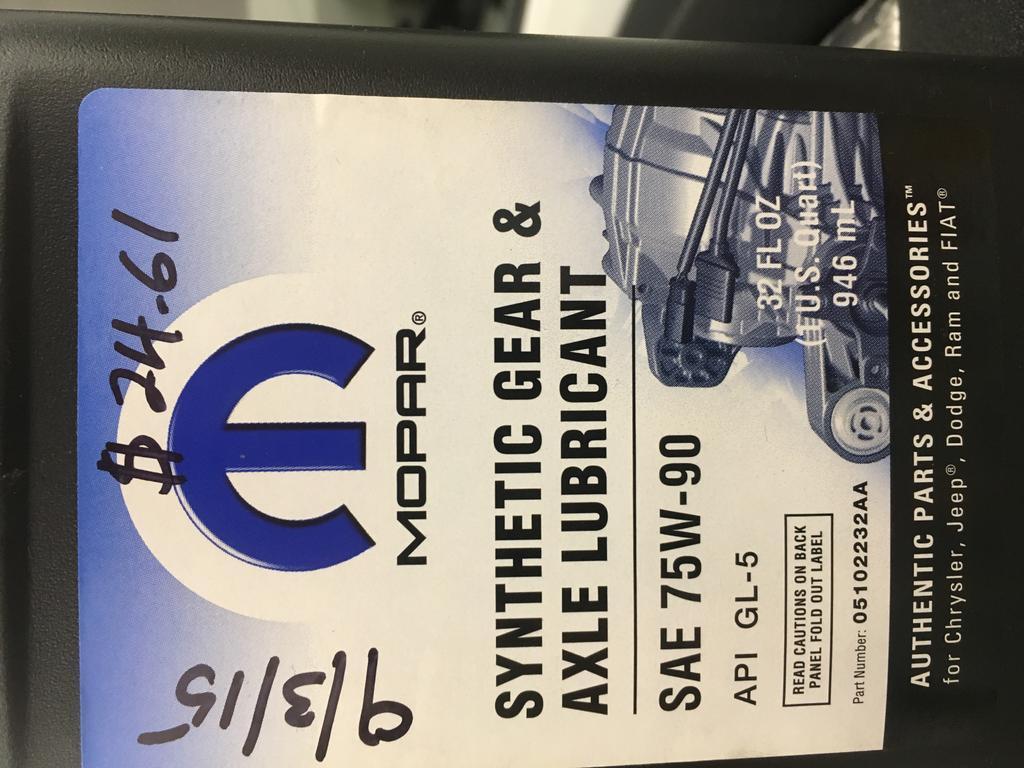

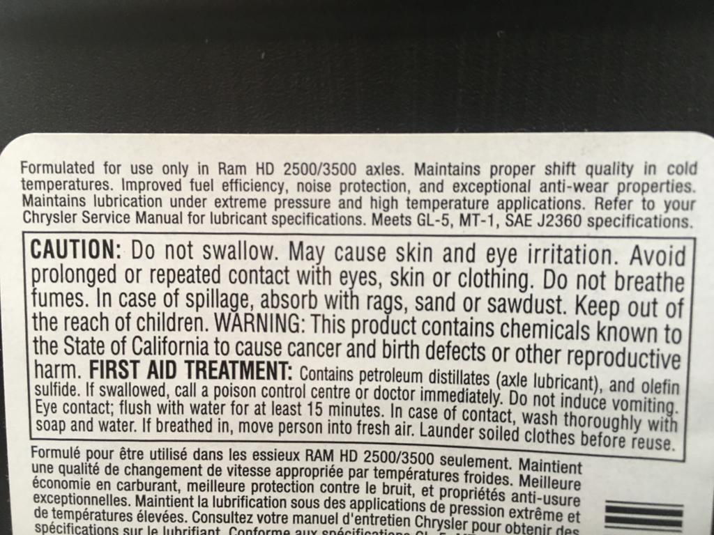

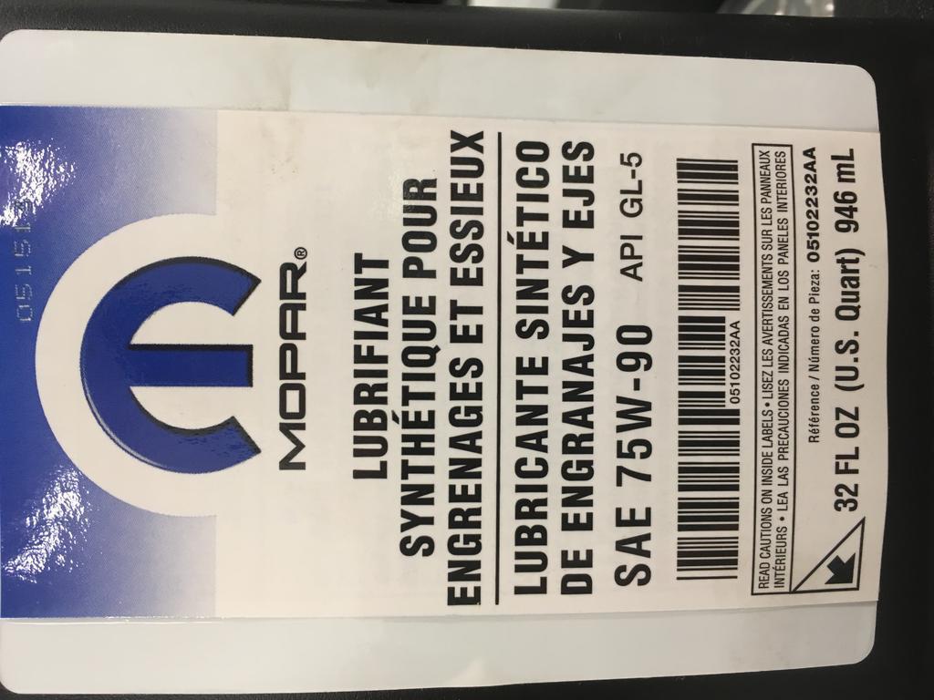

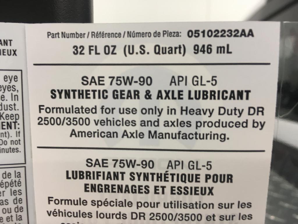

Here is the original lubricant for the American Axle differentials. This has been what I've used and was specified when the axle swap from the Dana axles occurred in 2002-2003 2500 and 3500 trucks.

im gonna change my rear only this weekend.i have 18000 miles , never towed more then 12000 pounds for about 6000 miles. I bought the mopar 75/85 . You guys think I'm in the ballpark?
Yup, you'll be fine. Keep everything clean. If you decide to wipe out the oil that wont drain, use lint free cloths. You don't want any fibers in the differential! Use a Jay's Easy Funnel to refill.
