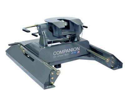

Without beating this issue to death let me explain my stand. With a single mounting point and a large footprint that the bottom of the hitch has the B&W historically has worked fine. There is no doubt that long time users have seen slight wear to the tubing and frame mounted slot for tubing. This slider hitch will positively grossly increase this wear. Although the large footprint sits tight to the bed floor I al sure owners can see rub marks on their truck bed. When you slide the slide back 8-10"s as you can see in my photo it will create a lever from center of kingpin slot to the tubing in the floor. Every severe movement laterally will begin to twist the hitch and twist the tubing slot.
#ad
My concern as has always been with the B&W hitch is one mounting point. And with this swinging hitch it will over intensify the strain on the single point. I am sure B&W engineers have figured out all the stress points and they are satisfied there is not an issue.
I suspect that the B&W engineers have run their FEAs and the hitch ratings reflect their efforts to maintain these stresses at acceptable levels. To wit, the gooseneck hitch is rated at 30K lbs, the non-sliding Companion hitch at 18K lbs and the sliding Companion hitch (if the figure mentioned previously is correct) is rated at 16K.

I am not a fan of the B&W hitch that uses the 2" mounting piece in the bed. I would think that with the new sliding hitch moving back and forth and at fully extended position is would certainly torque the 2" pin. Soon or later you may have a failure. I hope they have success with the new hitch.

For one I would never own a short bed truck. For those that have one I recommend an extended kingpin with air bag like the TrailAire with the standard B&W that way there is much less chance for cab damage.
The problem, especially with a 8'6" (102") wide RV such as mine, is that the extended pinbox doesn't change the WIDTH of the RV. As you approach 90 degrees, unless you have over 4'3" (51") distance between the center of the kingpin bore of the hitch and the back of the cab, the RV will contact the cab due to its width. Extended pinboxes may delay this contact, but unless the front cap has deep cutouts and the stars align just right, contact will occur.

I can see your point on the contact! But REALLY how many times have you had to jack the truck/trailer to 90 degrees to back into a spot. Im just asking!!!!! I haven't pulled a 5er into a campground but with our 32ft ball to bumper TT, a 90 degree back-in was never approached or even seen a spot that would be necessary to make a back-in with that much of an angle. Just curious we have been to quite a few National Parks and Many National Forest campgrounds in most of the Western U. S.

It doesn't have to be a full 90 degrees as the front corners of the RV stick out farther from the RV's kingpin axis than the sides (it's a triangulation thing - measure it if you doubt me) UNLESS the corners are cut back severely as is the case with some of the "short bed towable" RVs. Notice I said that the problem occurs as you "approach" 90 degrees, not once you reach 90 degrees. Typically, some one will screw up a truck cab when they need to cut just a little sharper than they had planned to back a long 5th wheel into a site (5th wheels require more input from the truck than a TT for the same trailer action because of the difference in pivot positions, and the longer the 5th wheel RV, the more truck input is required), or when they are busy looking down the side to miss a utility pedestal or a tree and lose track of how much RV cap-to-cab clearance they have left. That's why I said what I did about Murphy's law - no one sets out to hit the truck cab with the RV, but it still happens.
