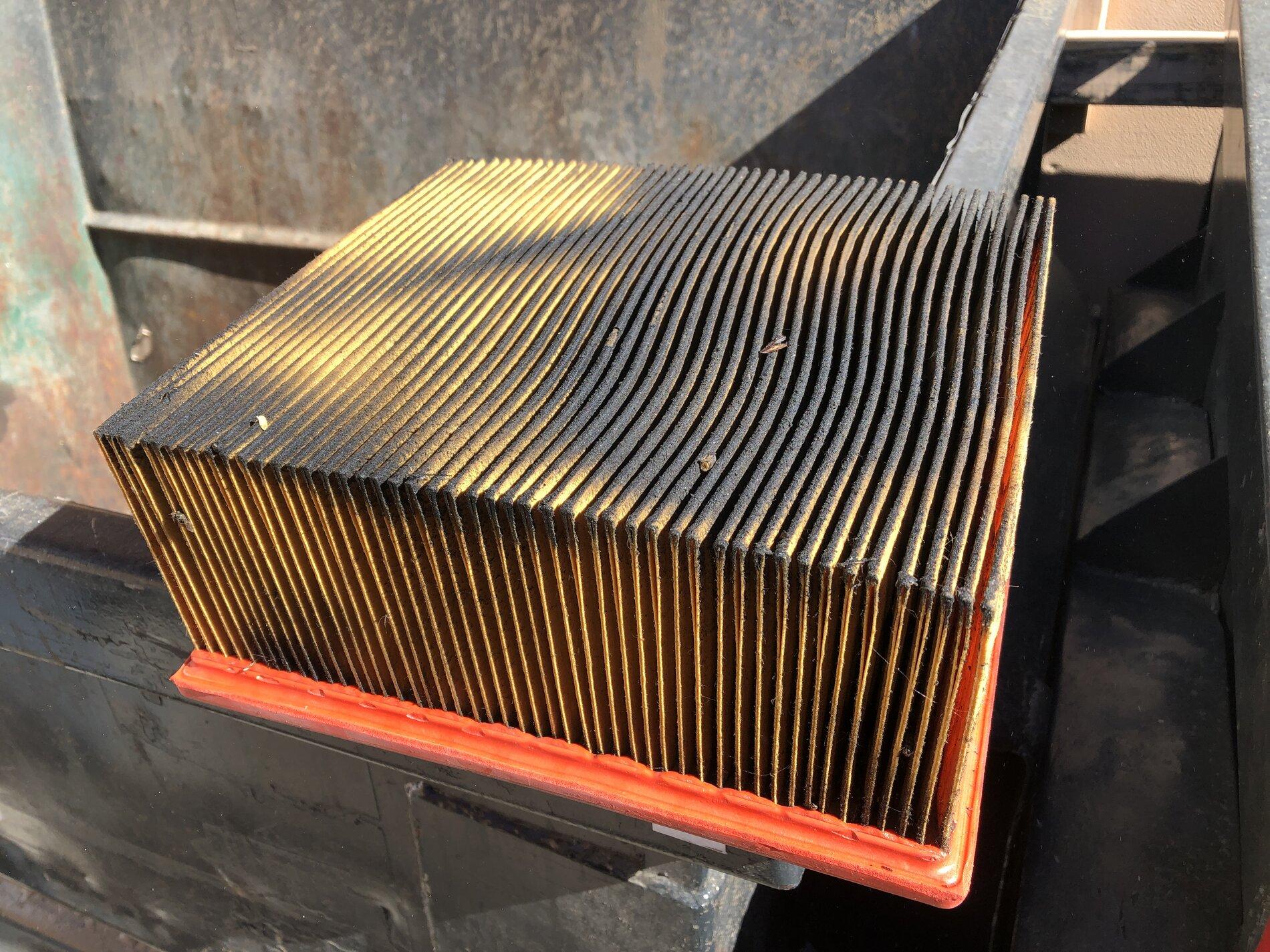

Really don't see what removing the air intake has to do with it. Looks like I forgot to tighten the lower clamp this last change but everything still looked good and filter was doing it's job as shown below. T
hat's 15k use.

Every 15k I changed my air filter and the first four samples were great. On every 12V or 24V I have owned the air intake came off to access the oil filter with excellent reports.
Truck is a Pavement Princess so it's fairly clean in the engine compartment.

There aren't many sources for silicon hence my comment on removing air intake piping. It takes a surprisingly small amount of dirt to show in a UOA. Major filter manufacturers like Donaldson and Fleetgaurd have a pretty firm stance on "over servicing" of filters and if you are swapping yours out every oil change, much less disturbing other connections I'd wager you fall into that category. We live in very different climates but my air filters get changed every 3-4 oil changes. I've personally only changed 2 filters through almost 100k miles of use. Again, very different climate but my silicon levels have never come close to that of yours (9ppm max across 4 UOA).
