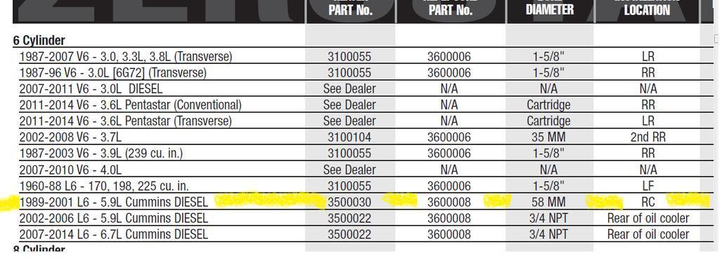

That block heater should not be much money, go to a truck dealer and get a Phillips/Temro 3500030.
Should sell for around $55.00 to $60.00 cord and all.

The threaded style block heater started with the STORM blocks which appeared in th Dodges in the spring on 97. It is a 3/4 NPT. The frost plug style were used in all the older "B" engines. STORM stands for Straight Thread O-Ring Metric. Those blocks also have provision for dual turbo drains :)
