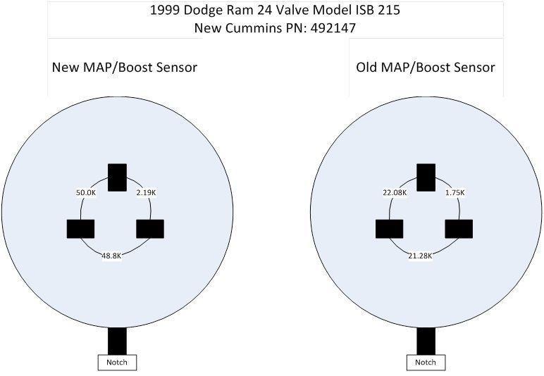

MAP/Boost Sensor is dependant on your altitude
I recently had a MAP/Boost sensor failure. The attachment is for the old failed sensor and new sensor at 3,000 feet. This sensor has a sealed area on one side of an electronic component (strain gauge, potentiometric, capacitive, etc..) and atmosphere on the other side during ohm measurements. Install it would be sealed area on one side of electronic component and intake manifold pressure on the other side.
