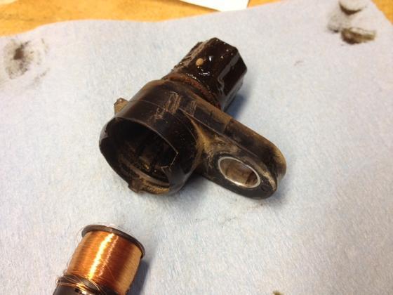

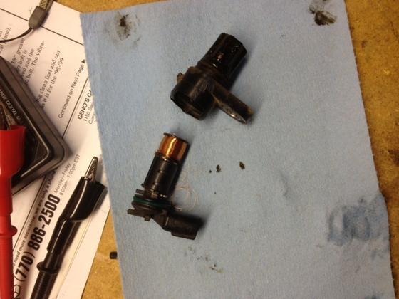

So, as I stated yesterday, my first order of business was going to be to check the rear wheel speed sensor. When I went to remove it this morning, the sensor actually separated from it's housing. The sensor came right out and the housing stayed in the differential. By looking at the new one, you can tell it is all one piece and not meant to come apart. Obviously I had found my problem. See pics:

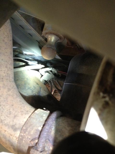

Now, as to why it was cracked, I can't say for certain, but I have a pretty good hunch. See this picture:
As you can see, I have one of those turn-over goosneck hitches. When the problem began I was hauling about 2000 lbs in the bed. In this photo I have about 1000 lbs in the bed. When the truck is empty there is a good 7-8" clearance between the bottom of the hitch and the speed sensor. In the above pic, that clearance has dropped to maybe 4". I didn't get under the truck yesterday prior to removing the load from the bed, but I'll bet that with that amount of weight, it was pretty close. One bump *might* have been enough to cause the hitch to contact the sensor and crack it. I'll never know for sure, but if I was a bettin' man...
One final thing, after installing the new sensor, I started the engine and while sitting there, the brake and ABS lights stayed on. Now I'm disappointed thinking something else must be wrong, but I decide to go for a test drive anyway. As soon as I got moving, the lights went out and have stayed out since!

I know on my 2002 4x2 3500, B&W supplied a plug for the gooseneck receiver when the ball wasn't in use. They specifically warned against turning the gooseneck ball upside down because it would hit the differential under jounce. Sounds like that hasn't changed.
This is really good to know! I bought the truck used and it already had the gooseneck hitch installed. I haven't used it so far and never had any info on it. I guess that is the hazard of buying a used vehicle and then not getting info on any aftermarket add-ons. Lesson Learned! At least it ended up only costing me $35 and an hour of troubleshooting.
