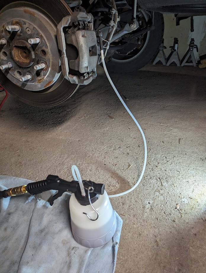

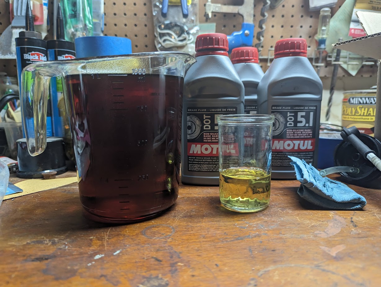

Below is 3 year old brake fluid pulled from my 2020 RAM EcoDiesel compared to fresh Motul DOT 5.1 recently purchased from Geno's Garage (thank you Geno's Garage!). Using a vacuum bleeding system and running an ABS bleed using my Autel scan tool.

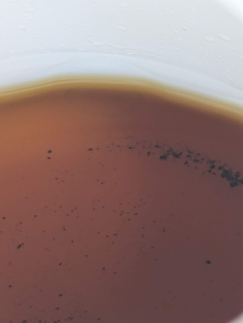

Note the color of the old fluid. I also tested it with a Brake Fluid tester and it indicated 2.1% water absorption which is middle of the road. Last photo is debris I pulled out of the system.

Brake performance is night and day difference.
You be the judge:
