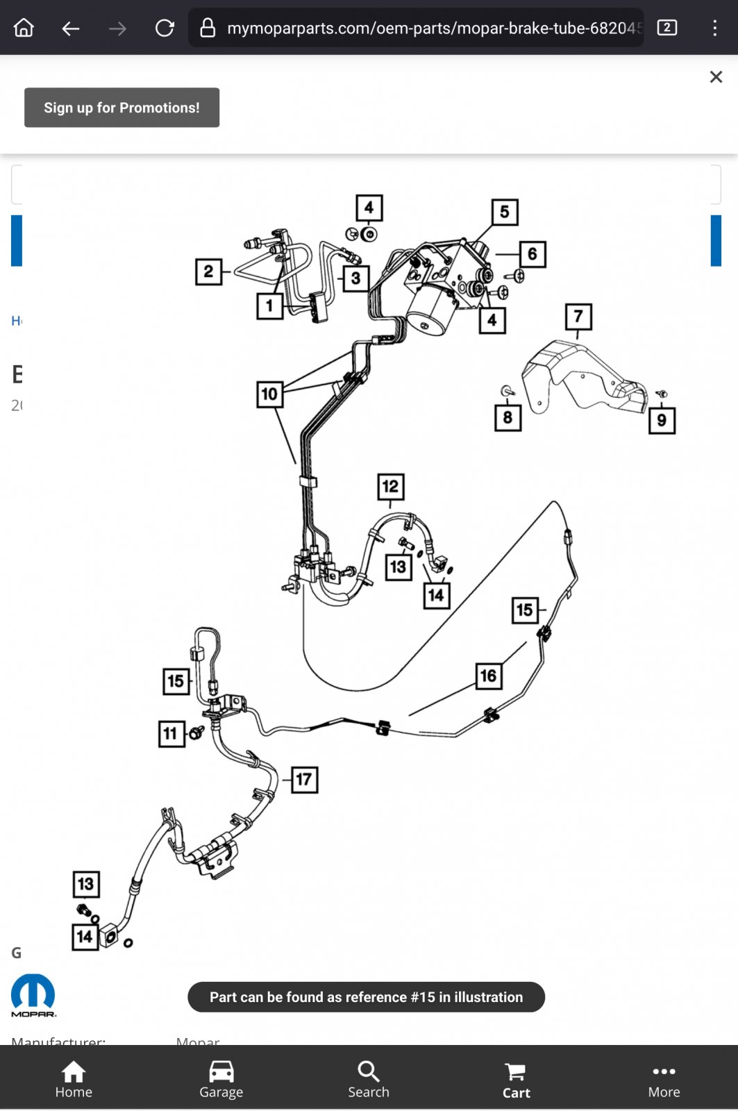

Those aren't "sets". Those are the two short tubes, one is the Primary tube and one is the Secondary tube. See the diagram below, #2 and #3.

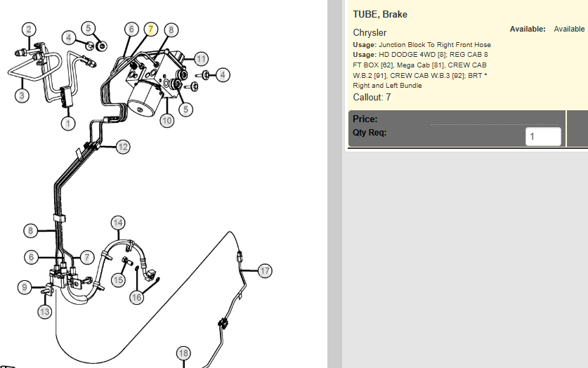

I looked up a 2014 from a VIN off AutoTrader and those three tubes shown as #10 in the diagram Ozy posted are listed as three separate tubes. #6 and #8 show "Not available", which means they aren't used on this truck. #7 shows as a "Right and Left Bundle", so I'd say it it's all the tubes.

Is that a generic diagram or vehicle specific? Reason I ask, #10 has three lines and I would need four.
The two lines I received from the dealer are two that I need, so I would need two more.
It is 4 lines, two are in Phase and so you only see 3.
I did a back search with the partnumber you provided and it always shows up as the #15 lines, no matter where I look for. The diagram is out of one of these searches.

That is weird, as this is the number he ordered and it shows in the diagram as #15?

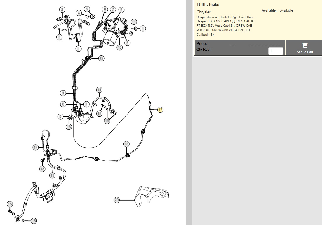

#15 on your diagram shows as #17 on mine. It is described as the tube from the "Junction Block to Right Front Hose" but it's listed as the same part number I posted above for #7, 68204550AG.
