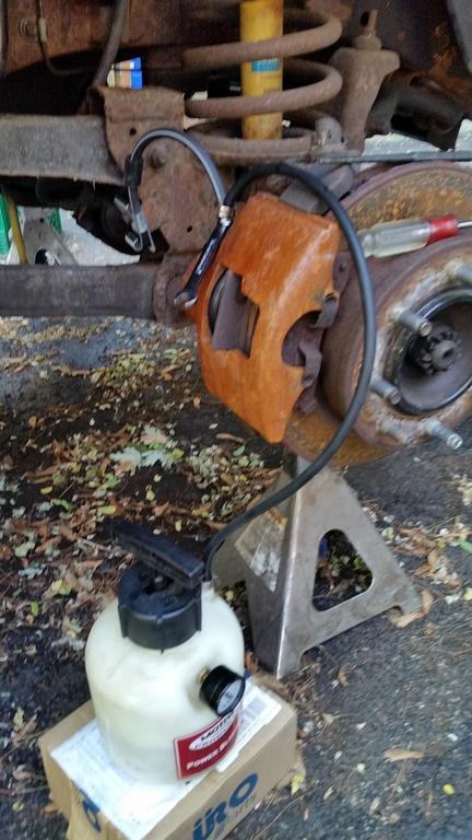

Ok, So I reverse bleed the Brakes rear, then Front again. First I put gas rated (yellow) Teflon tape on the bleeder screws so they would stop leaking by the threads. Then I got/adapted small tubing to go from the pressure bleeder tank to the bleeder screws and fit snugly. Then I pushed about a liter & 3/4 up the rear lines, then refilled the tank & pushed it up the front lines. After that the pedal felt soft / spongy.
I then set up the bleeder as normal, filled it with fresh brake fluid and bleed the brakes normally going around the truck two or three times.
eventually, I got a ok pedal: brakes apply after a couple inches, still sinks, but not all the way to floor, stops a few inches from floor ?!?
