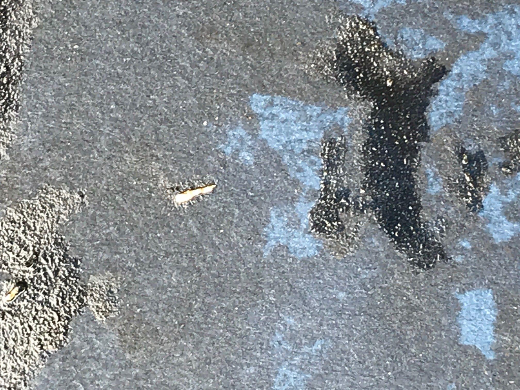

There are little copper like pieces at the bottom of my oil change pan. I will take a pic tomorrow of it when at dealer (I have to be there at 9am LOL.) they are not the glitter, real pieces about 0.5cm wide by 1 to 2cm long. I counted about 30-40 of them in the whole bottom of the change pan. Now I am scared.

They were not that big. Should have meant mm then. But they are solid and big enough for the shop and dealer to see. I still have the pan as well and will lay them out on black paper. Used a mm ruler to measure them.

FYI 1-2 mm is VERY different then 1-2 cm and I am sure that you would have gotten VERY different responses form members here depending on which one it is.
WHICH is it and can you simply post a pic of the pieces with a ruler (or even a coin) beside them for scale??

I'd suggest running a magnet over those pieces to see if they're iron; you should be able to differentiate between copper & aluminum easily enough once you brake clean the pieces.
When you cut the filter open, pay close attention to the contents in the outer chamber of the filter, rather than the chamber closest to the center (outlet) hole.

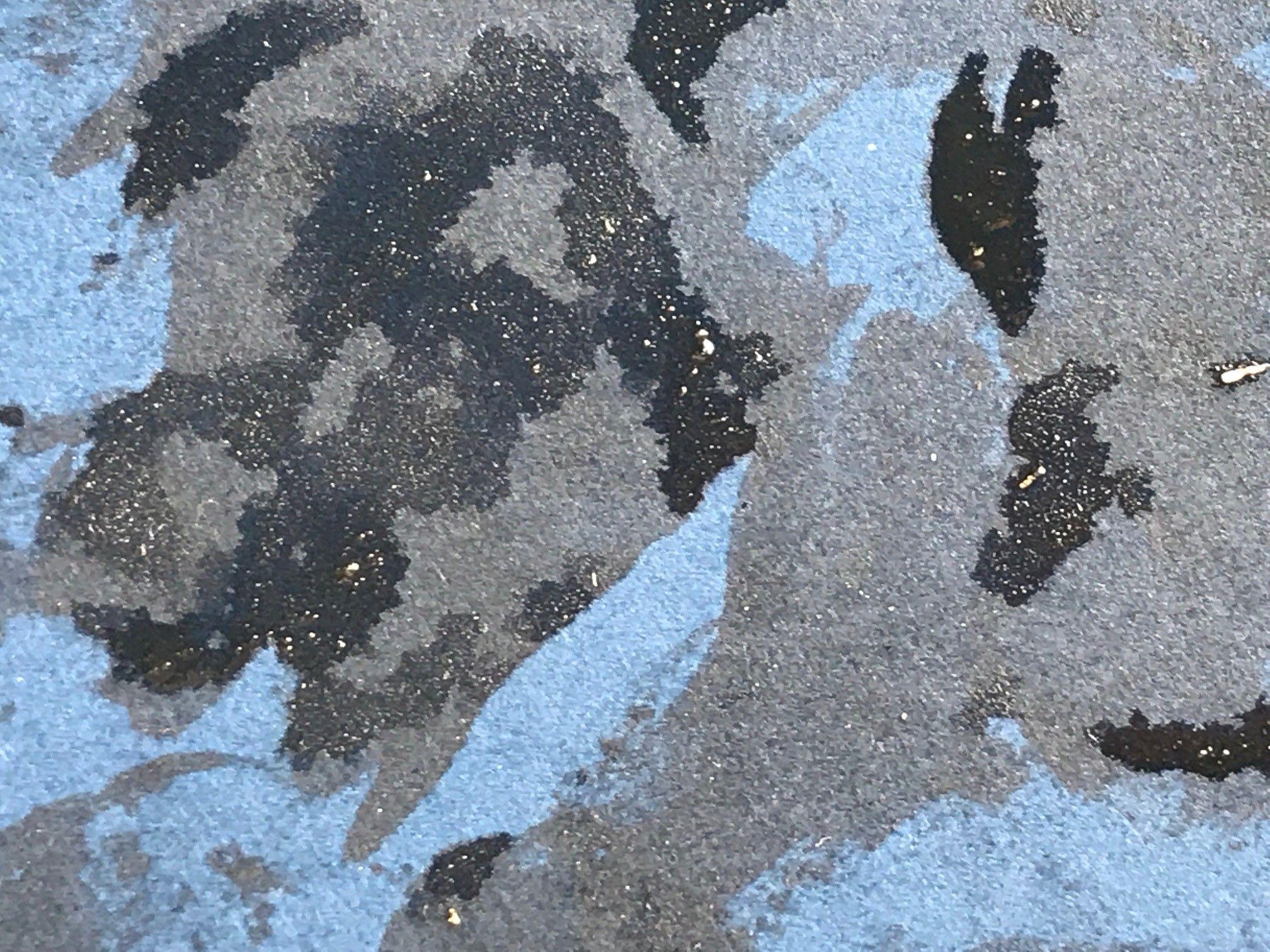

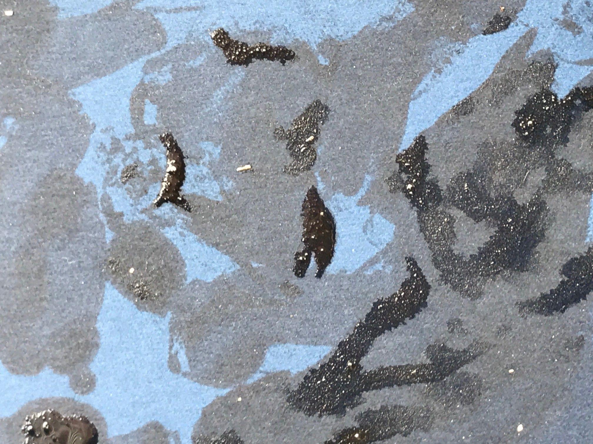

Ok, here they are. These are from the pan, drained from pan drain hole. There is more, just what I was able to get in the time I had. Surprisingly, cut top of filter, pulled out medium, opened it up, nothing was in the filter, anywhere. That made me feel a little better. I am assuming they were big enough NOT to go through the pickup tube strainer.
So, would this bother you? It did bother me enough. They did not perfume the truck as noted. Smells the same. Lol. So upset.
