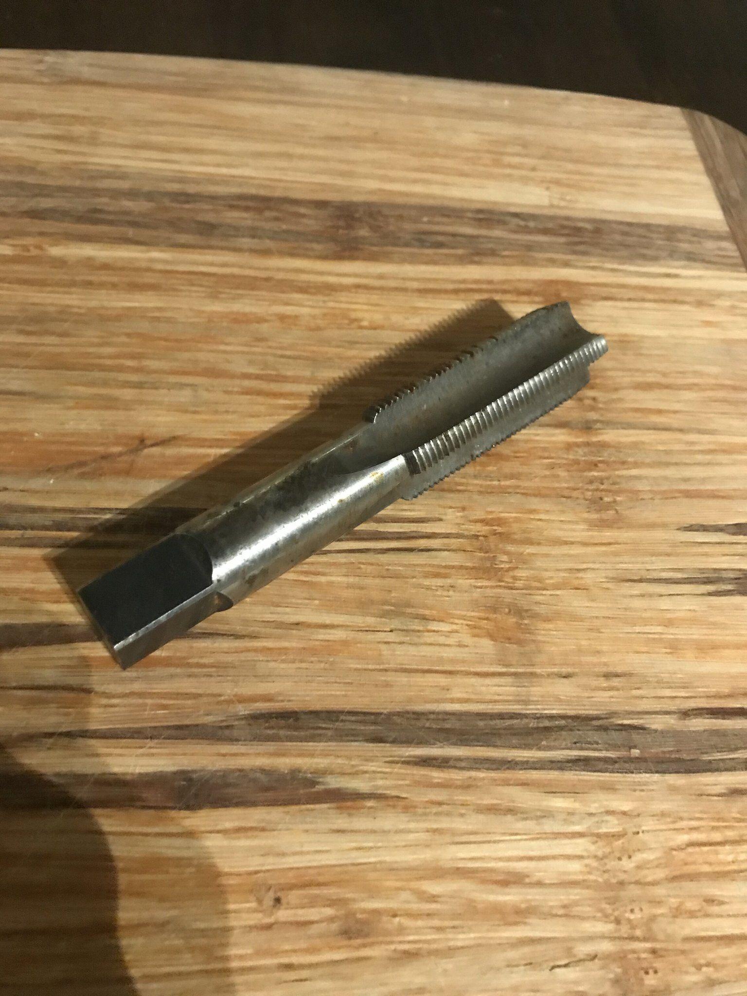

Funny you brought those engines up - I found this in my high taxed tool drawer yesterday -

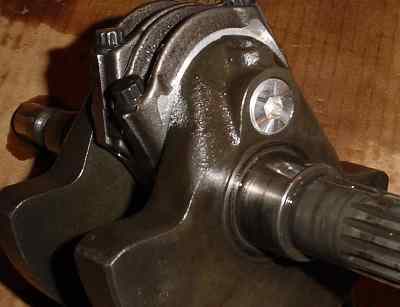

Since I already ruined the OP's thread, here is the "killer dowel pin" of mid to late 90s Ducatis. I misspoke before, calling it a welch plug, as it is threaded. They were aluminum and they would slowly back out into the roller bearing main which would machine it away until the last sliver let go leading to catastrophic loss of oil pressure. Later, they went to steel plugs. The fix was to Loctite and stake them, BUT you had to split the cases.
