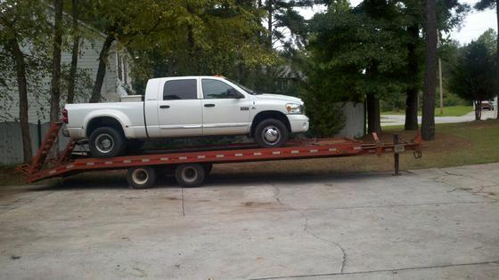

OK. So it looks like it's not as bad as we initially though. What I found is that the arm on the side of the trans that clamps around the "D" shaped shaft going into the VB broke from the excessive force required to get the trans out of park. Initially, it really looked like everything was moving like it's supposed to. Once I dropped the pan, I could see that there was no movement and I looked closer at the lever and shaft. I've ordered a new arm and a Sonnex park detent repair kit. Looks like this trans will live on. I know it has a lot of wear, but it will be interesting to see exactly how many miles this thing can rack up once I take care of this issue. This truck normally pulls equipment on the orange 12 ton trailer.
