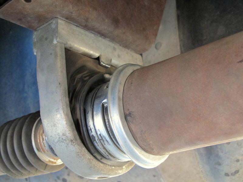

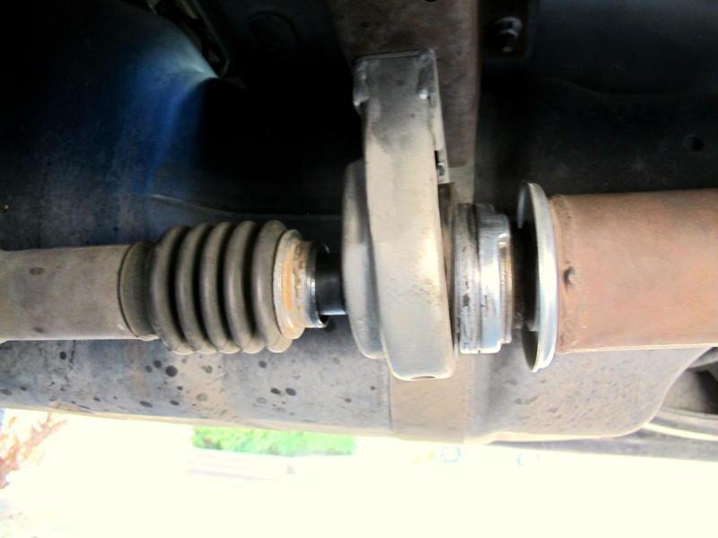

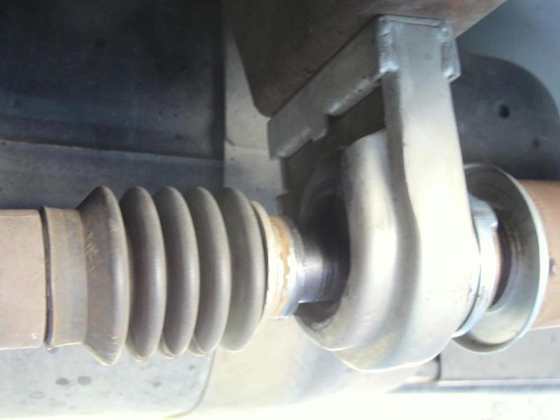

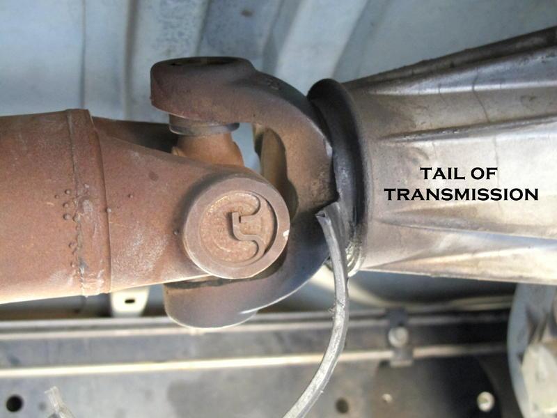

I replaced the carrier bearing on my '01 3500 about 20k miles ago... ... felt some slight vibration when starting from a stop, checked the driveline and sure enough... ... carrier bearing is shot.
Shouldn't this have lasted more than 20k? When I replace it this time, I was thinking that it would be wise to have the drive shafts balanced... ... Any thoughts? I thought I would go ahead and replace the U joints as well. My thinking is that if the drive shaft(s) are out of balance, that would explain the short life span of the bearing. View attachment 86866View attachment 86867View attachment 86868View attachment 86869
The pic of the front section of the driveshaft at whats labeled as the tailshaft housing shows that the shaft is indeed shoved forward. Look how close the slip yoke is to whats likely actually the tcase output housing. It has shredded the dust boot that's built into the output seal.
