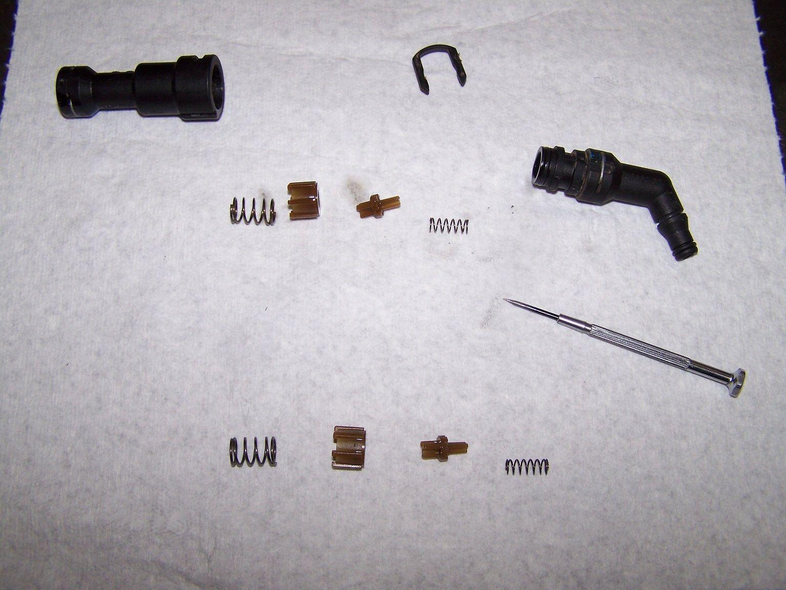

OK this is a pic of the flow control unit from a G56. The 45 is at the top right, kinda upside down . Not sure why I put two sets of innards in this shot, they only use one. Flow in this case is L-R for engagement (pedal coming UP) and the parts are in correct orientation.
And if you see a round "can" right under the master cyl, that's a NVH damper. I've seen them on CC but not pickups that I know of.
