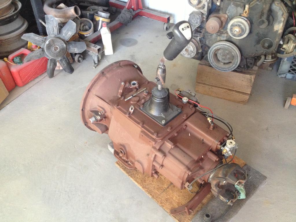

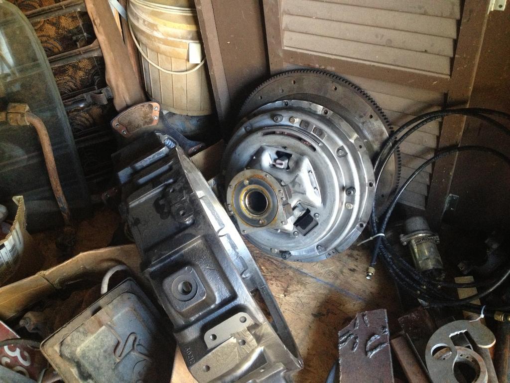

This RTO6610 is for sale local. A friend of mine sent me an e-mail about it about a month ago. It was installed and removed from a Dodge, 1st gen I think. The owner/installer towed an RV to the Northwest, drove back empty and pulled it out. I guess he didn't like it. I would guess that he is a dang good fabricator/mechanic but maybe not a truck driver in the sense of driving a 10 spd without sycro's. It is complete as installed.
I would like to have it for my Ford but I am spending all my money on truck pulls this summer:-laf Sorry, the pic's are kinda big I can't figure out how to make them smaller.
