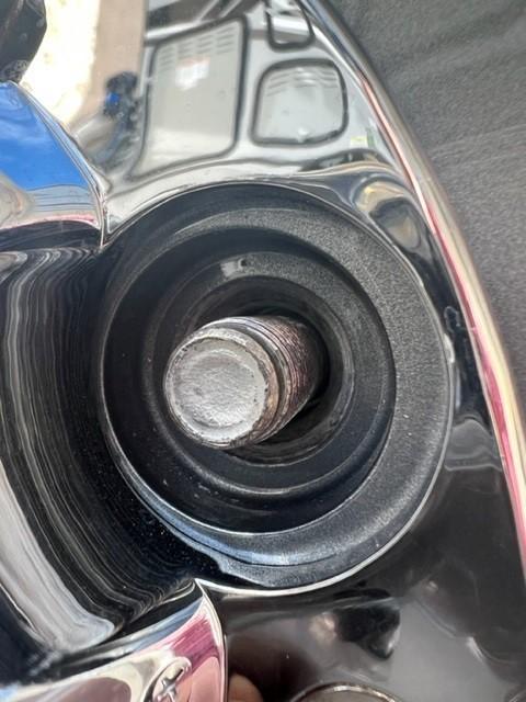

This is what my lug looks like and washer fits outer ridge. I assume the lug will hit the inner ridge. Also sent this to Vision to see what they think.

I sent the same picks to Vision who told me exactly what to order. I had some wheel shake so I stopped driving to reconsider this issue and thats when vision said shank and said the 17 inch and smaller are conical and the 19.5 are shank. Will see what he says when he sees the pics. I wonder whats causing wheel shake if true as truck was aligned just weeks prior to putting these on. New tires, centrimatic balancers, once Vision confirms or not that they ill advised me I guess its off to the balance shop
There isn’t room for a shank, plain and simple. Shank wheels also don’t have the taper for a conical lug nut.

I understand what you are saying but this doesn’t appear to be a 60 degree angle like my stoke rims and the short shank recommended may wedge in there and well as the washer that exactly fits the outer ring.

I looked at stock rims, distinctly different slope. I think vision is right that these are the short .5 something shank lugs they recommended but again, they have the pics and will see what they say. The recommended shanks are not long like the 1.7 you see online. They are short and look like they will hit inside pretty flat, the washer will sit flat.
The part number you listed has a .585” shank, too deep for the wheel you have.
While it’s a photo and not in person, that looks like a standard 60° conical seat.
