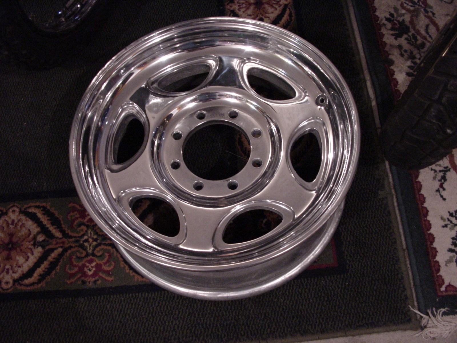

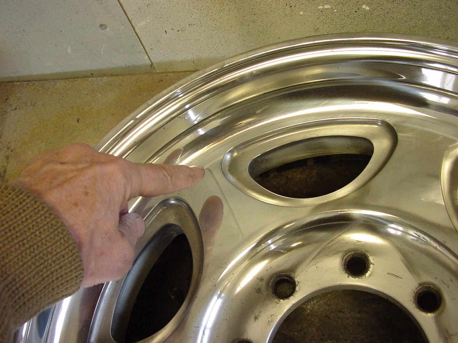

I looked at stock rims, distinctly different slope.
Per Napa, the '17 Ram 3500 srw uses this nut, as oem. M14-1.5x22mm in 60 degree taper.
https://www.napaonline.com/en/p/NOE82002221?impressionRank=1
Per one review on Summit, the 81a Vision uses a McGard 64806 nut, a 60 degree taper. It was for a 2nd gen so the tread was 9/16-18x7/8".
https://www.summitracing.com/parts/mcg-64806

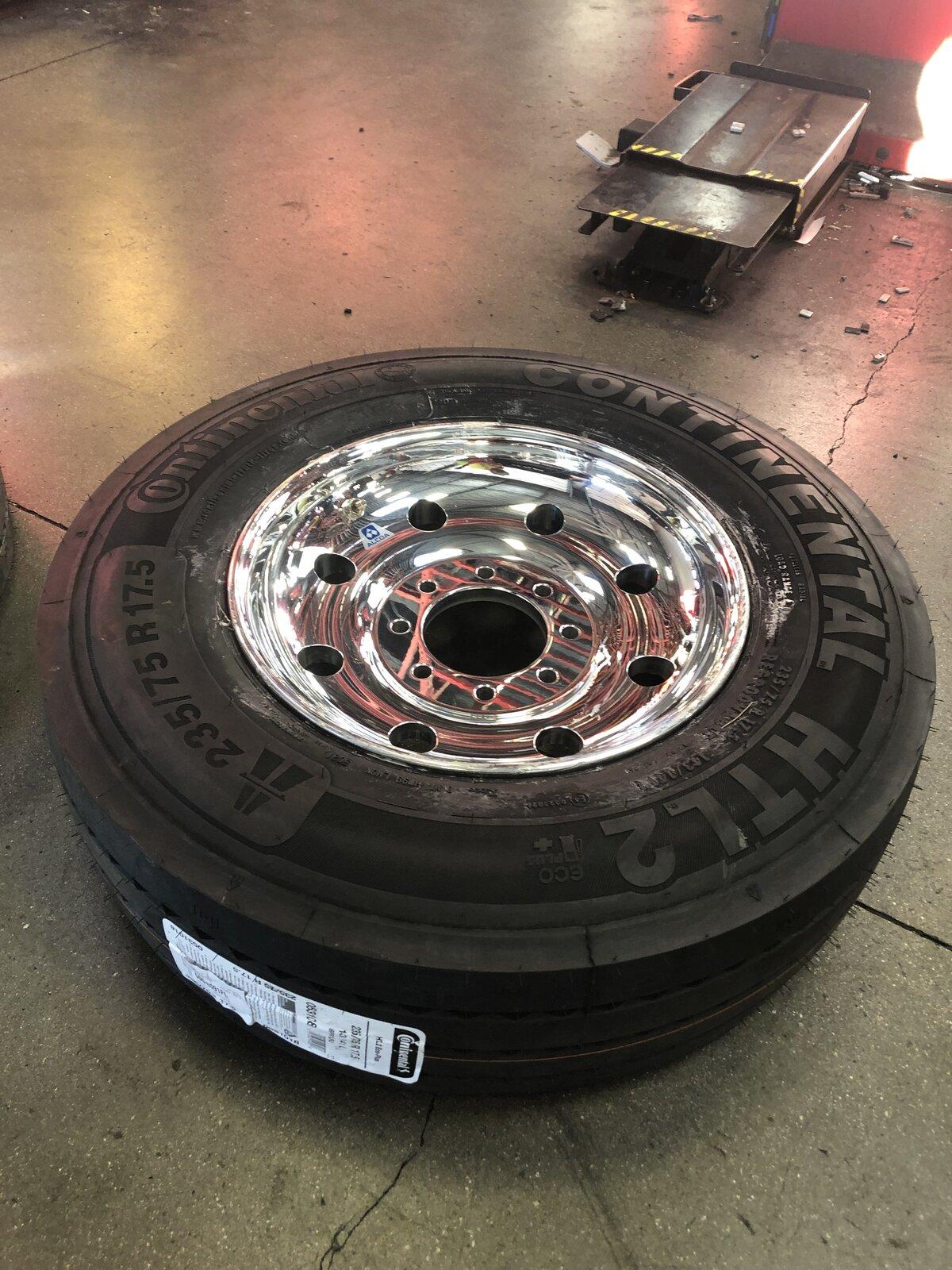

Confirmed today, they are conical. Vision apologized as the dully is shank. Returning parts. Wheel shake interestingly went away it seems after they looked at alignment. They said we didnt get a pre print out, here is your post. I wonder if they aligned and didnt tighten something and the tow or something was backing out. At least on initial drive home with only realignment I dont have profound shake. Will take back out on the road before I incriminate out of balance tires. They said alignment likely not the cause of steering will shake but I wonder about that now.
Thuren and on the way home now wheel shake. I will be surprised if that made that much difference as they thought not
have appointment in am to check tire balance but i am going to see if problem solves
Ricksons for a compar
Ok, here is my update, after rechecking alignment we pulled the wheels and the most that any of them was out was 6oz so we balanced, I left the centramatics on and reinstalled and no issue. They did tell me at centramatics that anything above 6oz may require balancing so it seems in the 19.5 size they dont have a balance ability that I would like to see like 8-12 oz. Anyway sharing for those of you taking the same path as me. You can tell the suspension works harder with the heavier tires but my adjustable shocks working much better than anything before. Will now load up camper and see where we are.
