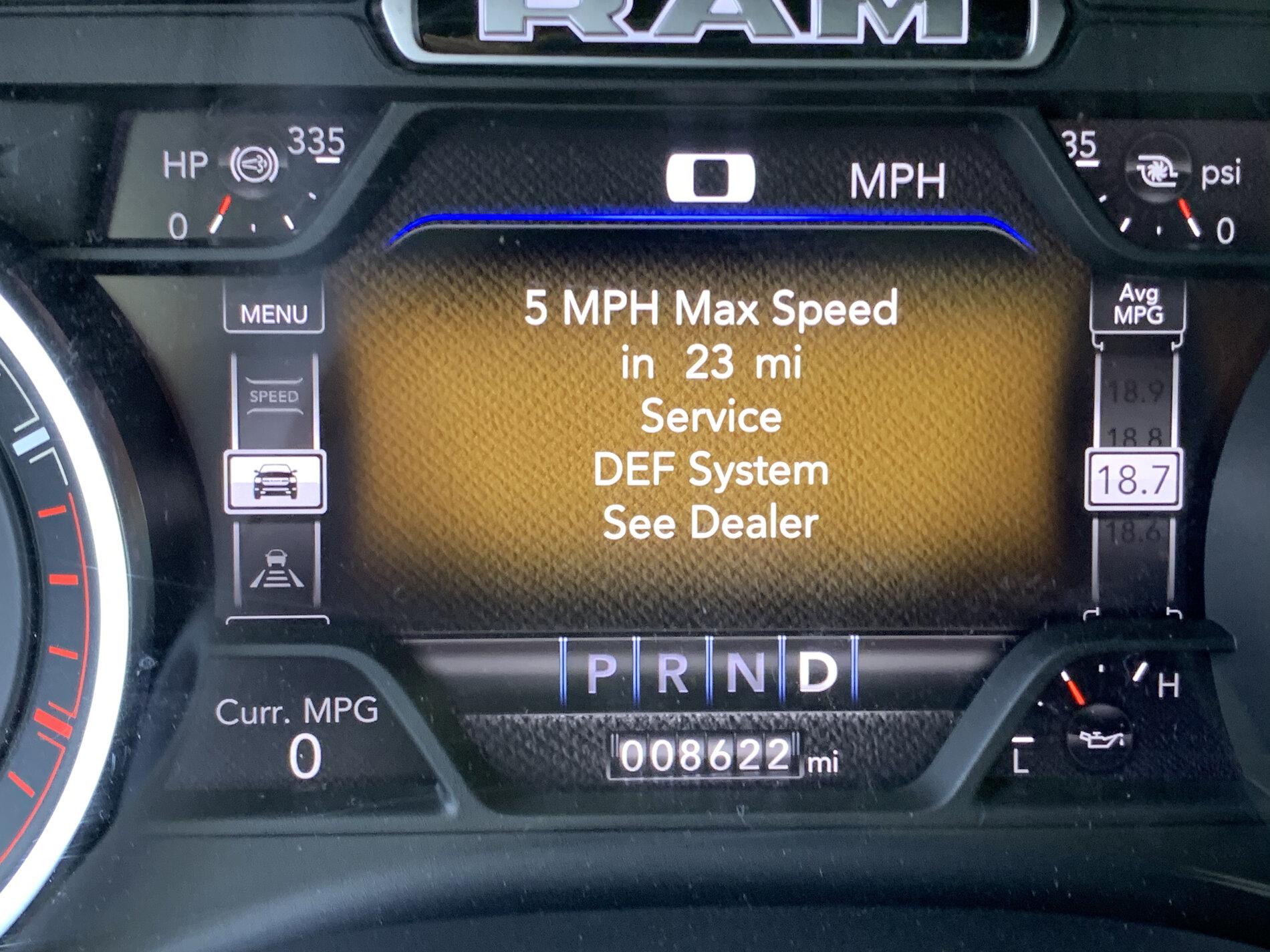

Driving home and the EVIC says to service the DEF system. Checked the code..... P203E, Reductant Level Sensor Circuit Intermittent / Erratic. Oddly today is when I filled the DEF tank with close near 5 gallons of fresh DEF. I wanted to use up as much stuff in the tank before I filled it up again. It was at 1/4 tank when I filled it... Just touching the red zone on the DEF gauge. I cleared the code and I'll keep an eye on it, With 8500 miles on it I should not be getting any "service" messages gosh darnit. Hopefully it's just a one time thing and resolves itself.
Code came back today minutes after I drove off. Had to drive 170 mile round trip, as I’m 40 miles into the trip.... EVIC display says truck is going to only go 5mph after 150 miles and to see dealer for def service.
Great, now I’m home with only 23 miles left before getting screwed because the dealership is 24 miles away.
I cleared the P203E half way through the trip but it came right back on and the countdown had not reset.
All because I filled the DEF tank from 1/4 to full??? Any trick out there other than possibly having to call a tow truck?

It has nothing to do with you just filling it with DEF. It's too late to do anything but fix it correctly. The only way to clear the message is flash it or fix it. And flashing only gets you another couple hundred miles.
I drained off about a gallon.... No more P203E code but the countdown is still on.....15 miles left till 5mph. Service advisor said it might clear itself out, Going to attempt to get to the service department in the morning.

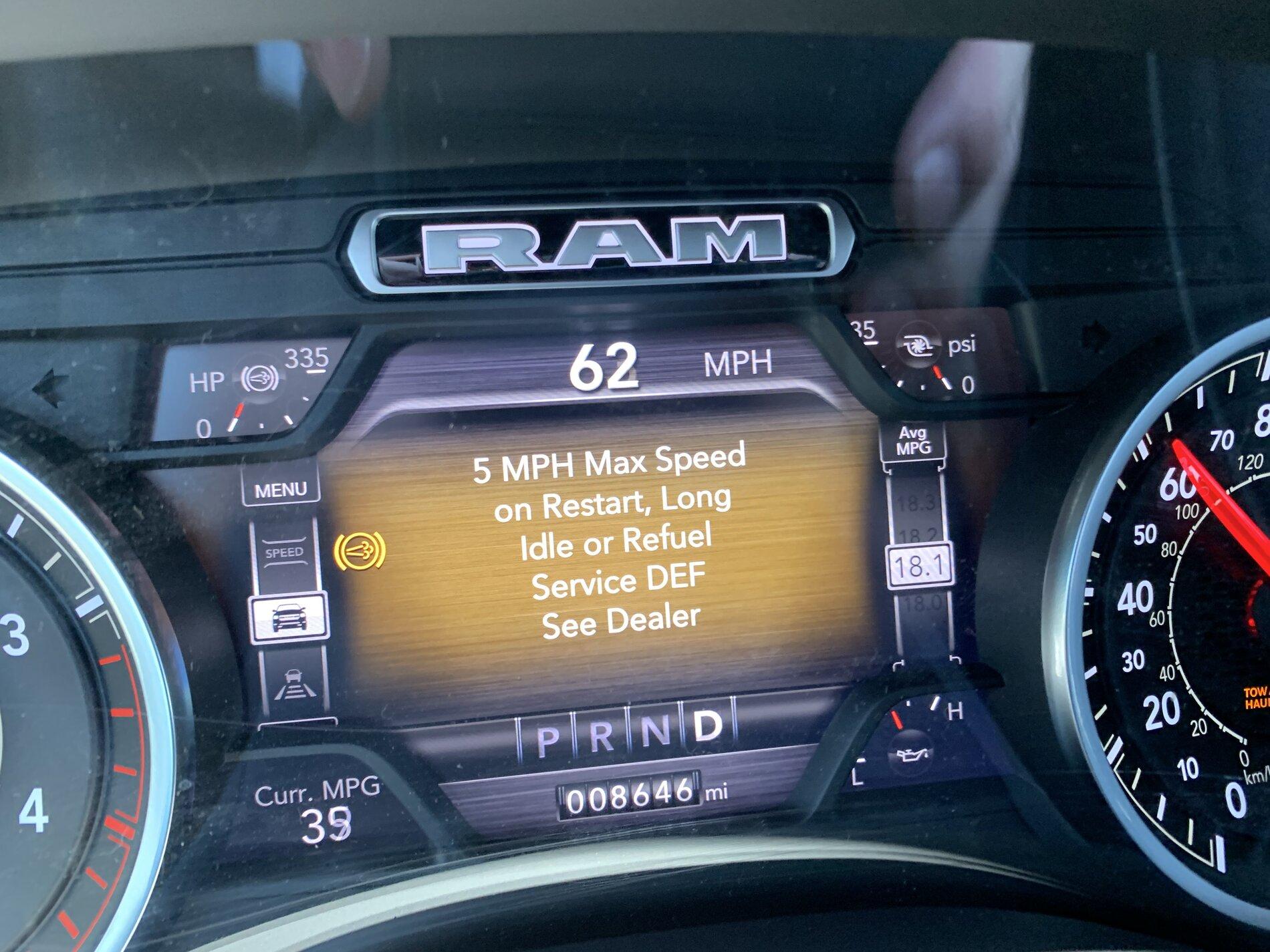

So.... When it hit 0 miles the message changed to "5mph Max Speed on Restart, Long Idle or Refuel", No change in speed or power availability. So then I just mashed the pedal to the floor and at 102mph the EVIC message went away, Usually when it would pop up with the countdown I'd have to hit any of the 4 EVIC nav buttons on the wheel to have the message go away... But at 102mph it went away by itself, Hmmm. I went to the "messages" on the EVIC and the "Service DEF" message was gone. Drove the remaining 12 miles to the dealer and when I pulled up I shut down the truck and plugged in my reader.... No P203E code... It still had not been back since yesterday. So then I started it up and drove down the blvd and back.... Full power, No derate no nothing, 100% normal truck. Pulled back up, shut it down for a few minutes, Fired it back up and drove around the block again. No codes, no messages, no derate. So I went into the service department explained all this and the "tech"came out and said he'd seen this before and said it was most likely from being overfilled and since I drained a gallon out... The level sensor stopped giving an erratic signal code. Since the code was not present when it hit the 0 mile mark it cleared the derate and that's why the EVIC message went away on it's own. So..... I made an appointment for the 16th for the valve body recall and the "engine calibration" recall and they'll check out the DEF system to be sure it's okay.
