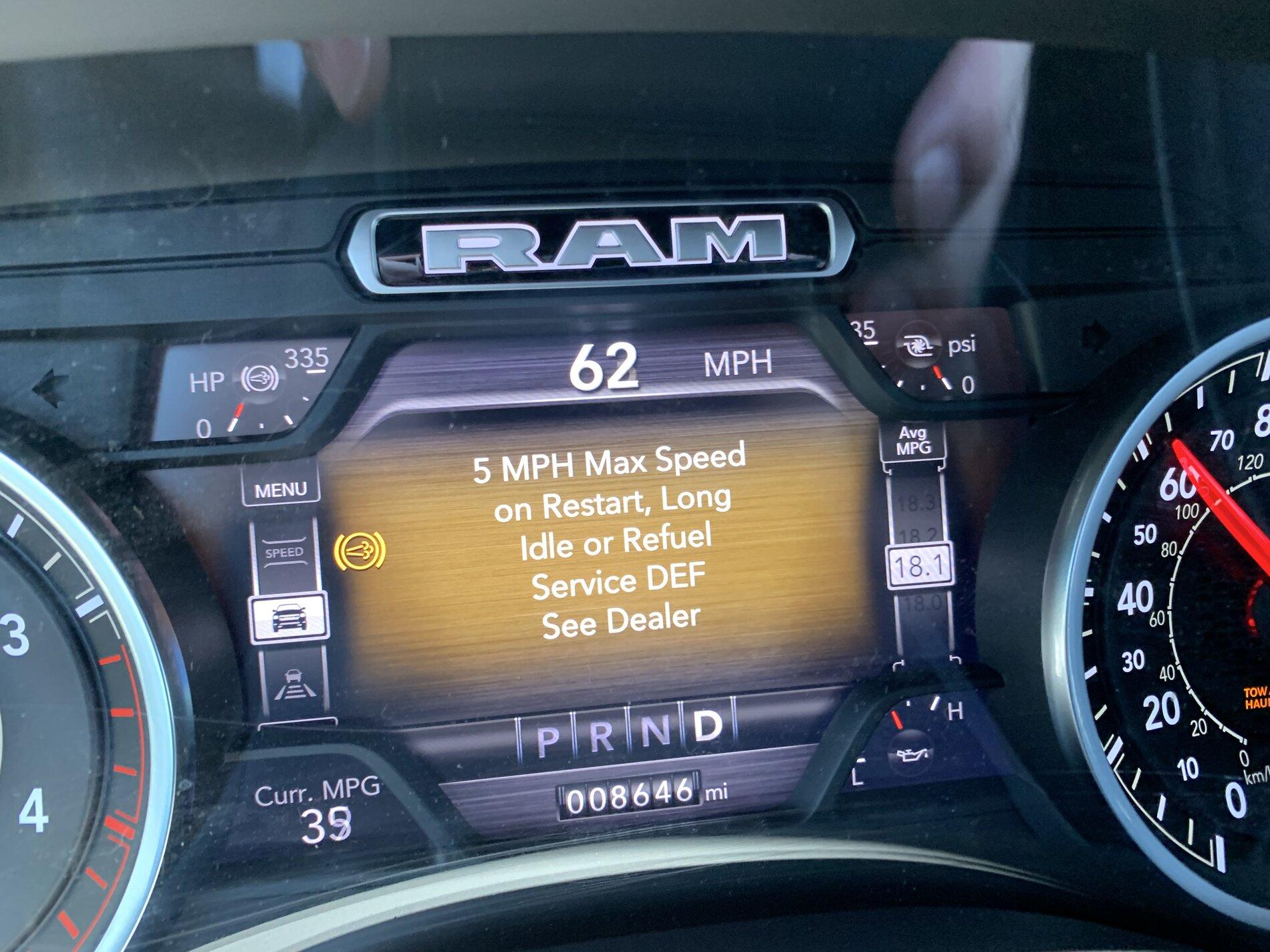

So.... When it hit 0 miles the message changed to "5mph Max Speed on Restart, Long Idle or Refuel", No change in speed or power availability. So then I just mashed the pedal to the floor and at 102mph the EVIC message went away, Usually when it would pop up with the countdown I'd have to hit any of the 4 EVIC nav buttons on the wheel to have the message go away... But at 102mph it went away by itself, Hmmm. I went to the "messages" on the EVIC and the "Service DEF" message was gone. Drove the remaining 12 miles to the dealer and when I pulled up I shut down the truck and plugged in my reader.... No P203E code... It still had not been back since yesterday. So then I started it up and drove down the blvd and back.... Full power, No derate no nothing, 100% normal truck. Pulled back up, shut it down for a few minutes, Fired it back up and drove around the block again. No codes, no messages, no derate. So I went into the service department explained all this and the "tech"came out and said he'd seen this before and said it was most likely from being overfilled and since I drained a gallon out... The level sensor stopped giving an erratic signal code. Since the code was not present when it hit the 0 mile mark it cleared the derate and that's why the EVIC message went away on it's own. So..... I made an appointment for the 16th for the valve body recall and the "engine calibration" recall and they'll check out the DEF system to be sure it's okay.

Driving home and the EVIC says to service the DEF system. Checked the code..... P203E, Reductant Level Sensor Circuit Intermittent / Erratic. Oddly today is when I filled the DEF tank with close near 5 gallons of fresh DEF. I wanted to use up as much stuff in the tank before I filled it up again. It was at 1/4 tank when I filled it... Just touching the red zone on the DEF gauge. I cleared the code and I'll keep an eye on it, With 8500 miles on it I should not be getting any "service" messages gosh darnit. Hopefully it's just a one time thing and resolves itself.
I have a 2016 3500 and when mine was new it went crazy . Service def would come on and off , no codes , no mil and it would go away . 5 or 6 trips to dealer no answers, even took a picture to show them. Eventually it tripped a code , turns out that a pin in one of the connectors had pushed back making a intermediate connection. Took 5 min to fix. Great truck but too much electronics, but they're all the same.

Well, you wasted your time and fuel doing the hard driving thing, that is not for the DEF/SCR system, that is for when the DPF gets full (which is a separate unrelated system), the hard driving helps the DPF regeneration cycle work quicker/better, but has nothing to do with DEF or the SCR system.
Very likely though, the gallon of DEF you added was weak from being old and having been stored in the truck. The system then detected the low potency of the DEF, and tripped the see dealer message. These messages often go away after some normal driving and a few restarts or after filling with fresh DEF and driving some.
