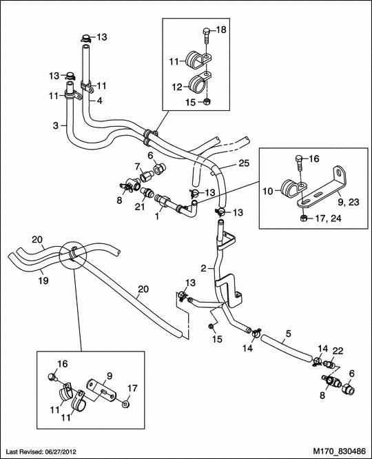

The majority of trucks still use manual shut-offs right from the factory and they are on both the pressure and return line. But those valves are there for two reasons, 1st being to aid A/C efficiency in hot weather and 2nd the ability to isolate that coolant loop and keep on trucking in the event of a heater core or line failure.

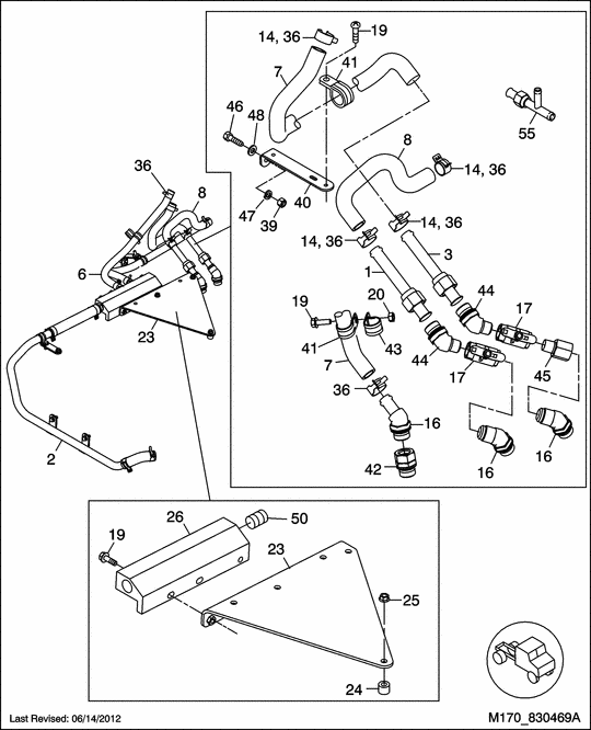

Western Star Day Cab (Item 8 in two locations)
Coronado Day Cab (Item 17 in two locations) (Item 26 is new, that is a 5 port coolant junction block)
Mike.

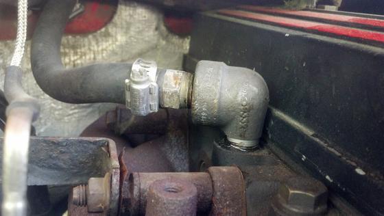

Note the low profile compared to the valve cover. This was a schedule 80 street 90 so its even bigger than a schedule 40. Since the valve cover has to go towards the passenger side before it comes off, this gives you more room to work with. You could come right out of the 90 with a valve of your choice, and everything stays nice and low.

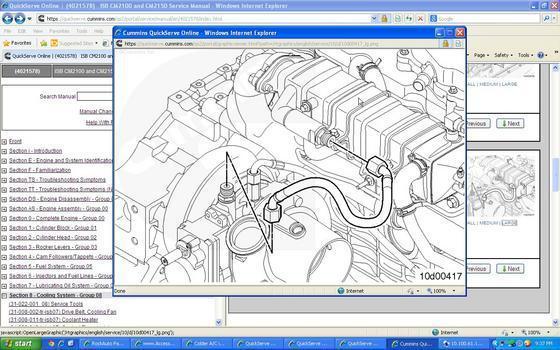

Maybe our one-winged MWilson can pull up some pictures. I sifted through QuickServe, but couldn't find it.

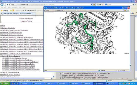

The problem with blocking the flow on a 6. 7 is the turbo water feed line is the same as the heater core line. If you shut off flow completely, you can/will cook the turbo. I believe they are connected in series. I don't remember though.
One of the AC rebuild threads talked about it, but I can't find it now.

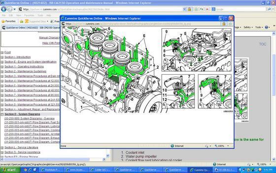

I'm baaaaack... ... .

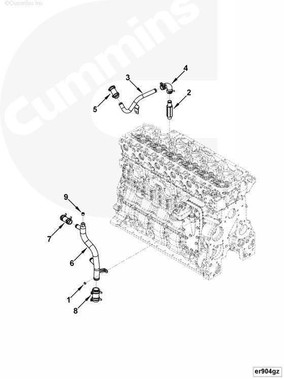

Ok, here is what I have found in regards to the 3rd gen 6. 7 heater feed lines.
I want to stress that the transmission cooler / heat exchanger is NOT supplied by Cummins from what I can see so I need to do some digging on the RAM side of things.
Using Harvey's truck and engine for show and tell this is what I see...
Heater Plumbing. .

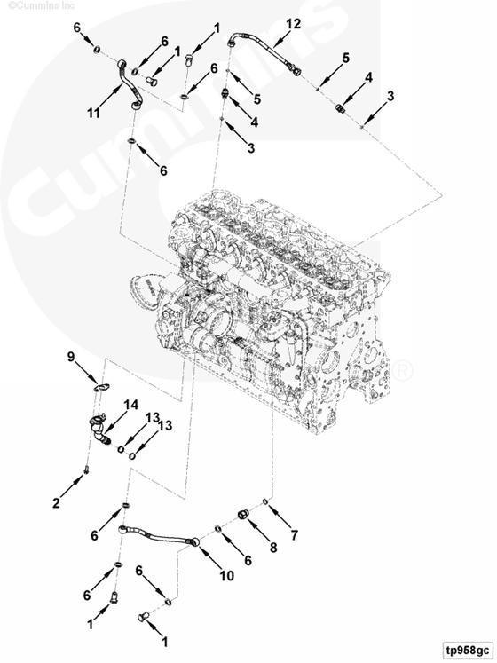

Turbo Oil And Water Plumbing...

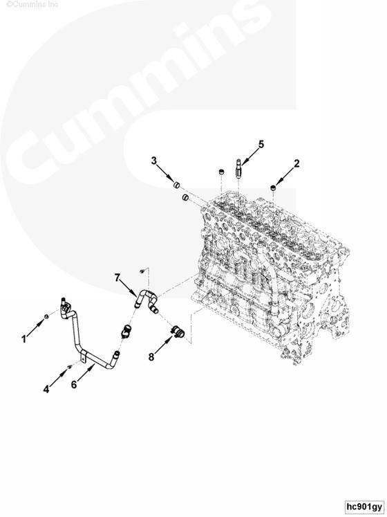

EGR Water Plumbing... .
I don't see anything in series involving the heater pipe for the components shown above, there is no "Y" in the heater pipe like the 5. 9 autos and the block fitting is in the same place.
Only wild card is the transmission cooler, but I did find the shipping plugs that Cummins installs in the ports that are used by RAM for their own cooler and those are metric o-ring boss so they are not part of the cabin heater plumbing.
The turbo coolant lines are attached to the block (lower line) and EGR cooler (upper line) according to the service manual so that may be where the shared flow statement came from.
So with that being said, I don't see why a shut-off may not be installed in a 3rd gen 6. 7 truck.
