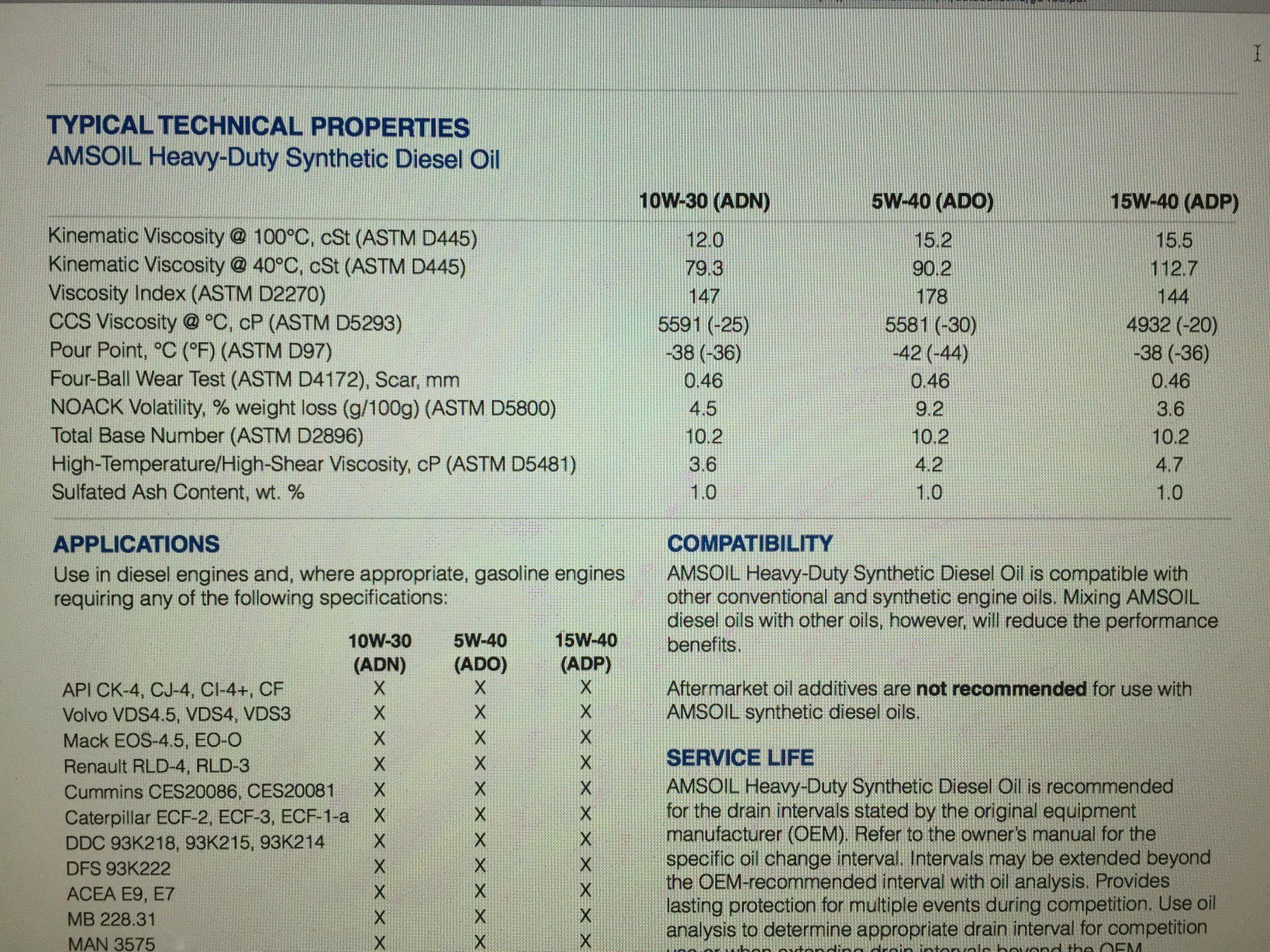

I'm using Valvoline 5w-40 Premium Blue Extreme Synthetic diesel engine oil. Even though I'm in SE Texas (rarely see temps under 20F). What the heck, it's 40w oil when our temps are near 100 and the price always seems right on AMZN. And being 5w, the truck has a low load when started. Why use 15w-40? Why change to a different weight when the 5w-40 covers all temps we will ever be in. I know some swear by Amsoil and I do get some of their stuff but their good synthetic is just plain pricey.

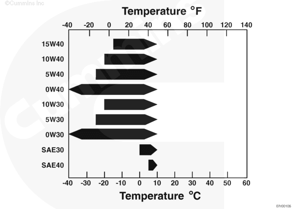

straight from Cummins.. recommended viscosities and temps..
Exactly why everyone should run the 5w-40.... it covers the full range from -18 up......
Except there are some 15w 40 oils with the same cold -39/-40 cold pour point as Valvoline 5w 40 PBE which would suggest they flow equally well at -20°F/-30°C ????
Interesting to see that if you never leave south florida, you could use straight 30 weight, straight 40 weight, and I'm betting even straight 50 weight.
