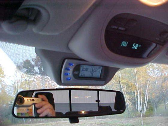

To anwser your question about the edge working with aftermarkert turbo it works great. I think I was able to use it to full power when I got the turbo "mines a hot juice 185hp/390tq". The only problem I have had is the edge reads the maps senser for the boost reading an with a aftermarket turbo you have to put in a boost fooler, so the the edge gauge only reads what the boost fooler wants the truck to think its getting for boost... So there you need to install a manual gauge"when an if uyou install an aftermarket turbo".
Also about the speedo recalibration with bigger tires the edge has a mph in the gauge an you can change it to fit your tires, BUT changes it in the edge gauge not on your dash. You will have to go to the dealer an have them change it. The edge juice works after the ecm so it doesnt change any thing in the ecm it just goes in line after ecm an before the motor. Another thing I like is you can let other people drive your truck with out worring that there going to go above the limits because it will defuel it self
About the high idle be thankfull you guys have 48re not g56's. I went to the dealer to get the high idle an they want me to buy another $300. 00 part on top of the $90. 00 flash, because while its idling they dont want it to jump into gear some neutral saftey switch. Good luck with the smarty everyone that has them seem to like them. ive been thinkn about gettin the JR after I do injector .
