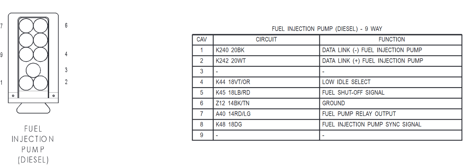

You should perform Test #3 with the wiring harness disconnected from the PSG so that all possible electrical problems will be eliminated.
Supply power to Pin #7 on the PSG (using a 10 amp fuse) and supply a ground to Pin #6 on the PSG.

I did unhook the connector and had ground and power but I’m wondering if I could be getting intermittent power supply or ground ? Truck tries to fire every few revolutions but then acts like no fuel supply at all for a few revolutions, That’s why I’m wondering if it might be ecm related ? The guy from thoroughbred said the ecm has to mounted to the engine or it will fry it so Monday I’m going to swap them out just to see what happens
