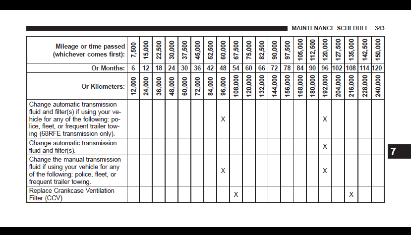

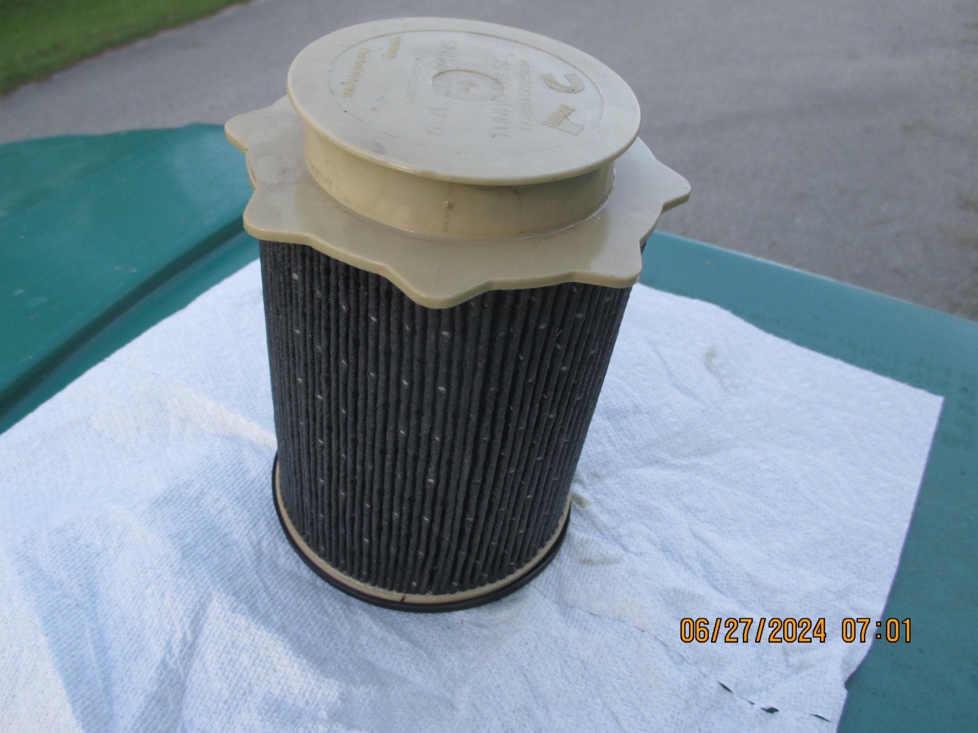

I just replaced my CCV filter 4k early as I’m going to be driving to AK next Summer. I did the reset procedure even though I did not get the message. Will this reset the clock and it becomes 67,500 from here?
You'll still get the reminder, as it based on a mileage calculation, and not when you do it with reset. Let's say that you didn't do it to 70K +/-, you do the reset "dance", next reminder will be @ 135K. With that being said, have the reset procedure handy. You'll need it at 67.5K, or listen to the ding and display for a "few" miles!
I would plan on the next filter change, check the cooler and EGR for cleaning the soot out. On mine, I did mine at 130K, due to not knowing the previous time. I can say from what I encountered, every other time should be sufficient. At least that's the plan on my rig.
