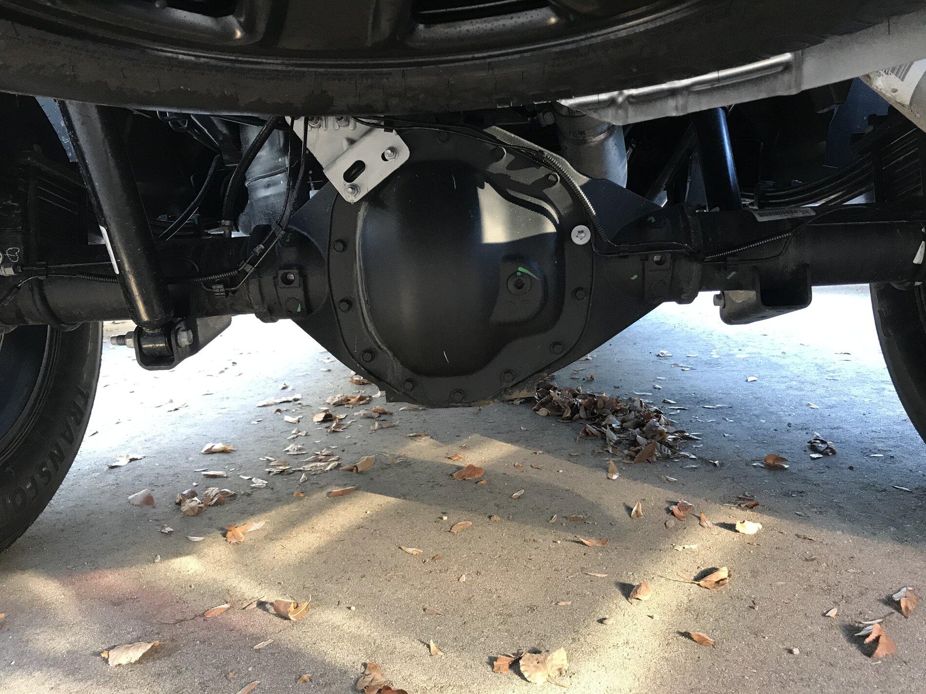

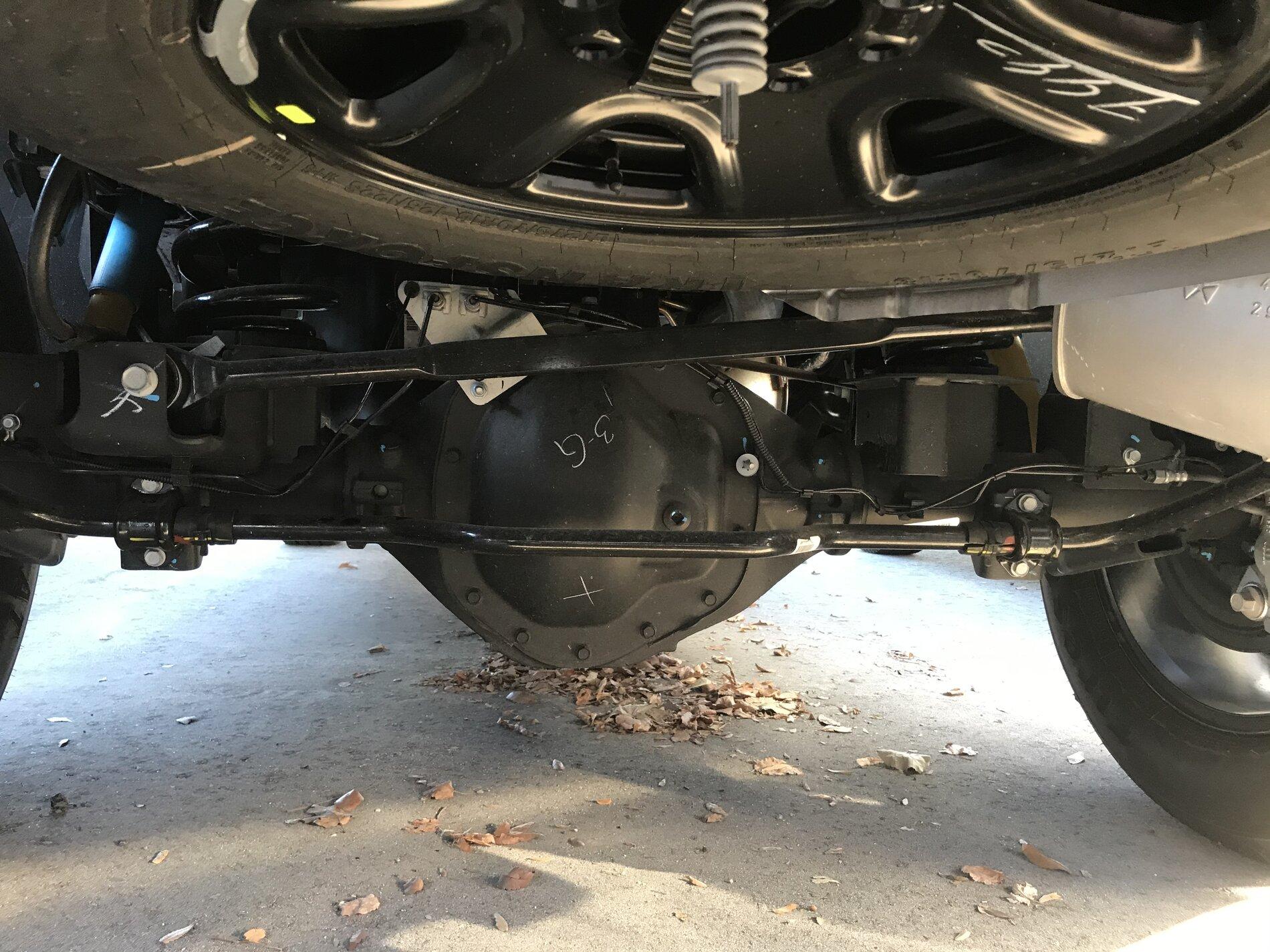

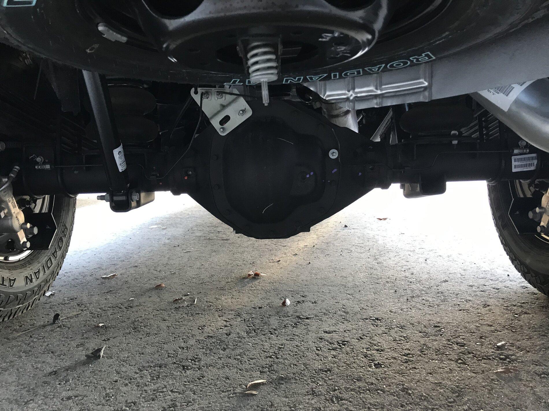

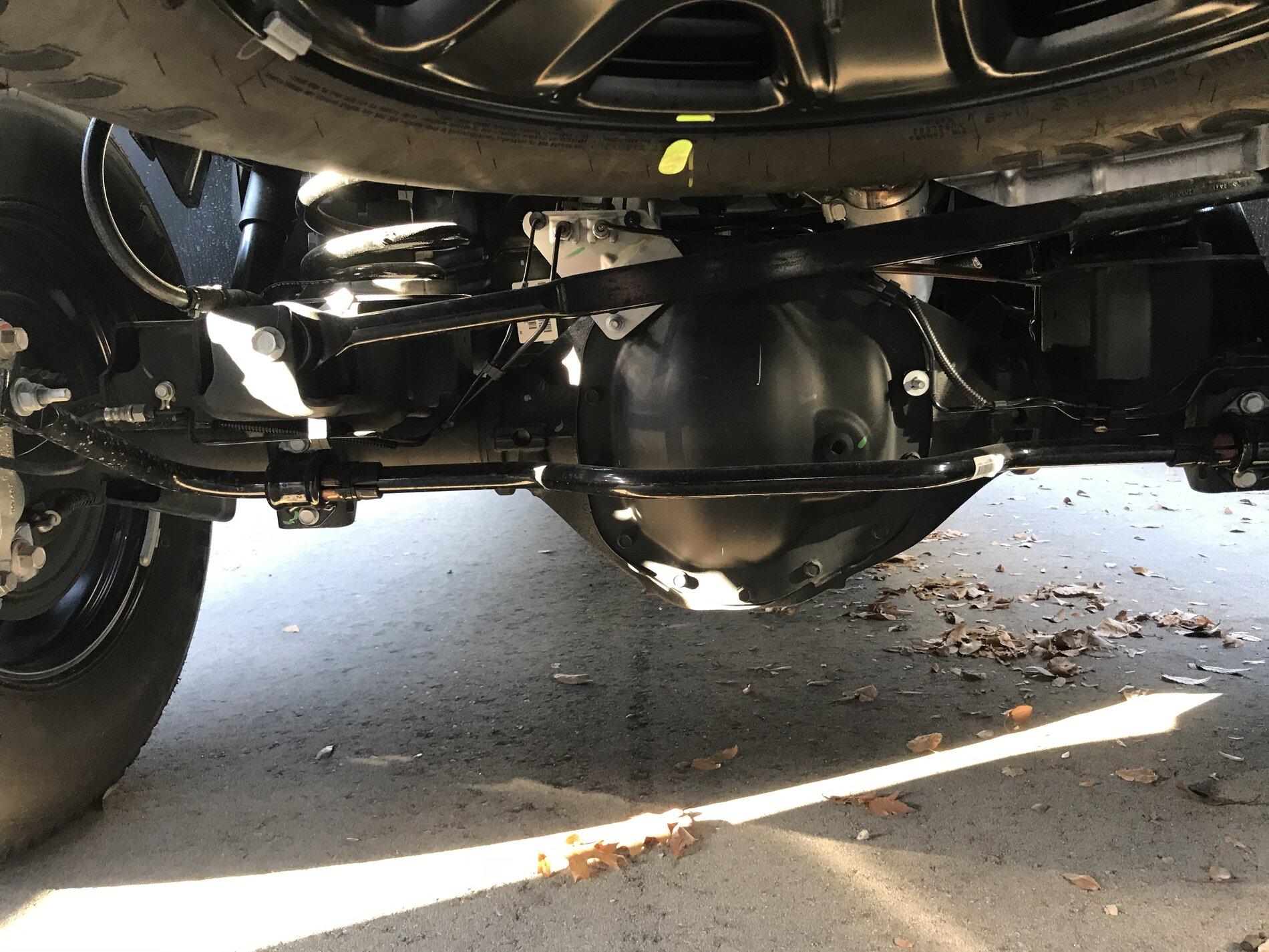

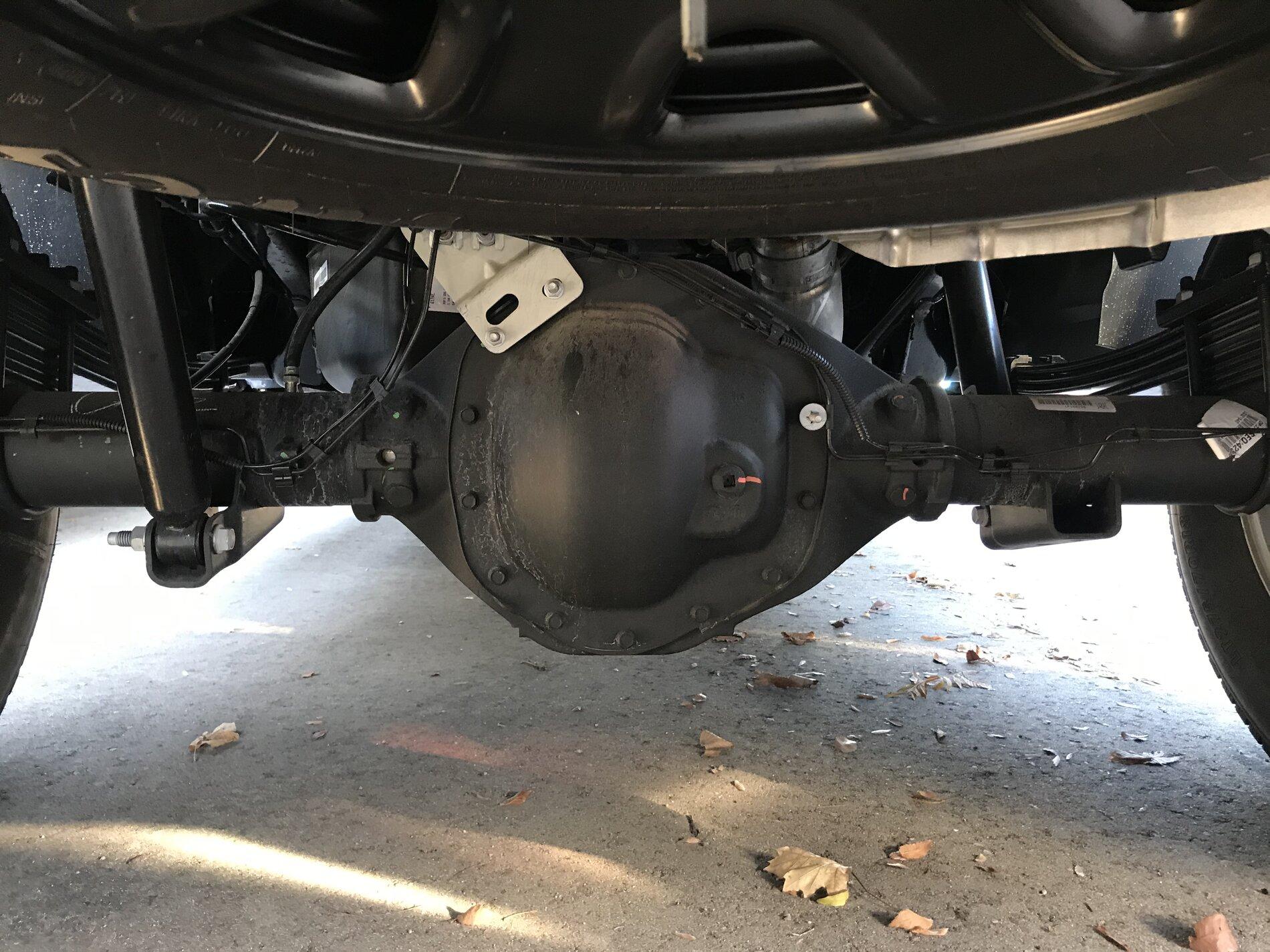

It's not a bigger axle, it's the same 12" AAM axle. The difference is the ring gear bolts and carrier to accept the additional bolts.
The AAM axles have always had the same vertical load rating for SRW or DRW.
Whatever the method, the Ford got better MPG when dividing miles by gallons. Ford's new combo gained MPG, whether it's attributed to tuning, or the 10 speed. The CGI Cummins are thirstier on fuel and DEF than -->'18s were.You mean the click wait then click method? NOT hand calc in my book. I fill to the top every tank, that’s hand calculated.
It's to my understanding you can only get the 12" rear diff on a Dually 3500 Max tow, read that on the Ram website and you'll notice it when you build a truck, but all 2500/3500SRW are 11.5.
2018 and lower (not sure how old back), with the Dually/H.O./Maxtow you got the 11.8 w/ the finned rear diff cover.
Interesting.. I'm not doubting you, but did you actually take measurements of the axle?
Maybe they do this to order a bunch of the same axle housings and save cost that way by just changing the R&P.
I'm surprised to not see a cooling finned diff cover on the 3500 DRW HO.
