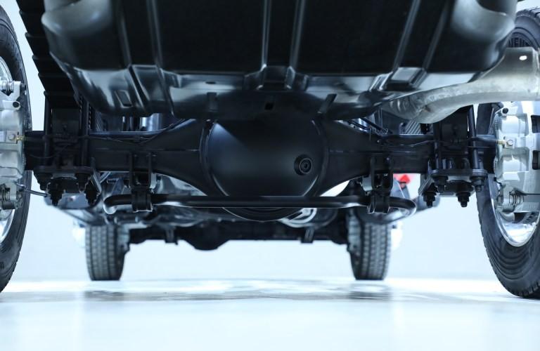

"Ram Chassis Cabs get a 12 inch AAM rear axle while 4×4 models get a 12 inch AAM rear axle and a 10.5 inch AAM front beam axle with a center disconnect. A multitude of gear ratios are available ranging from a 4.10 all the way up to a 4.89 ratio depending on Engine/Transmission and model configuration."
2019 Ram 5500 Chassis Cab rear axle....Looks a lot like the big Dana.

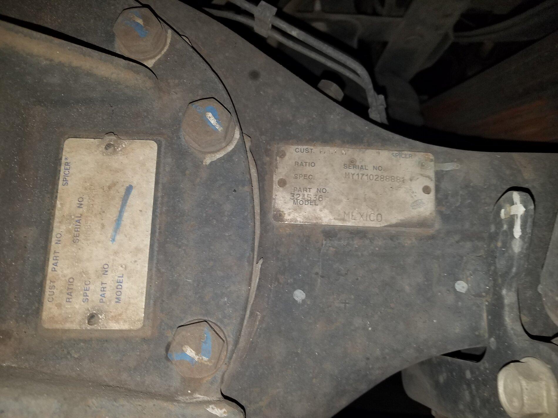

Interesting the different nomenclatures they have for the same component... the rear axle on mine has a tag that lists it as a Dana S110, but my FSM lists it as 310 RBI. Actually, the FSM doesn't ref Dana at all. The FSM on my 09 4500 referenced the axles with Dana names. Interesting.
Cheers, Ron
And......I’m presuming the nomenclature for the front is in millimeters (275 or about 10.826”) and the rear (310 or about 12.204”).
