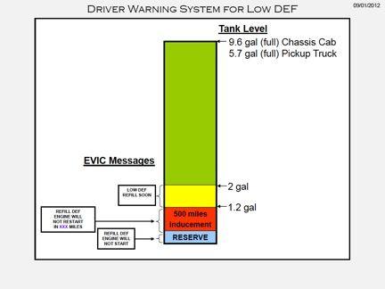

I've ran my '14 over 65 miles of the south side of zero miles to derate. It kept on going.

This diagram from RAM explains the sequence in which the messages appear.
