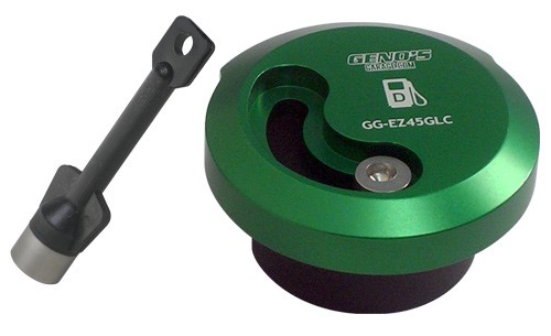

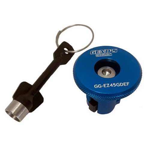

I don't trust anyone to not put something in either tank during the night so I spent the coin last year and got these, also if you have lock on the def tank opening you can't by accident put diesel in it unless you were take both caps off at the same time....
View attachment 138920 View attachment 138921
Thats a great idea, especially since I don’t have lock on my fuel fill. My diesel cap is a quick style spring loaded one, I’m not a fan. Mostly because the top is all grungy and I can really clean it.

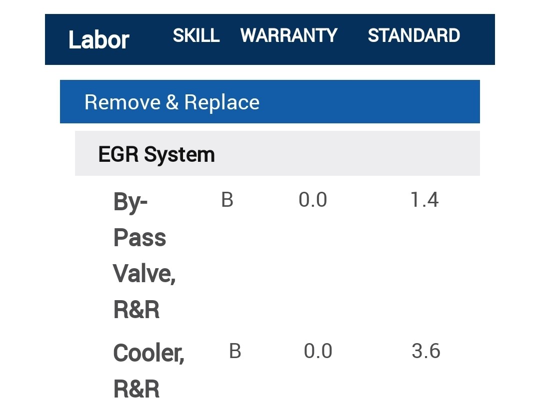

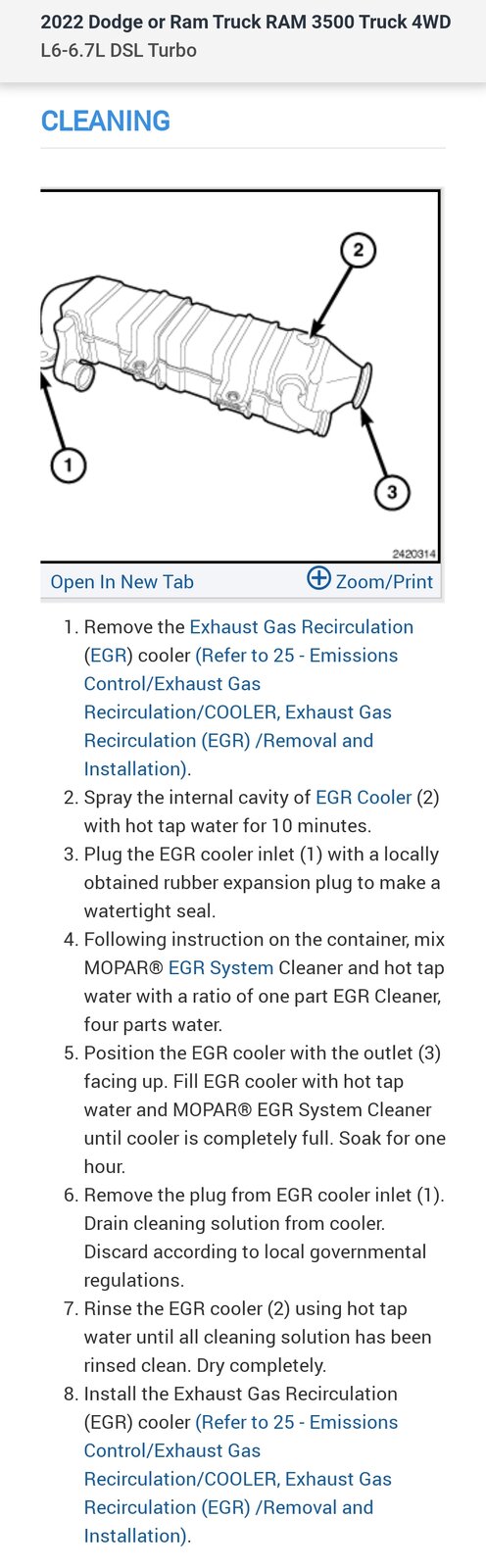

What is a full EGR service on a 2020?
Yes, that’s what they told me. Carson Dodge quoted me $800 and the Placerville dealer quoted me $1,600 and said they do a much more detailed service. I decided to go with the more detailed service just because. I’m not looking to cut corners!
I’d be curious as to what the service really is since it hasn’t been a Ram recommended service on the 13+ engines.
They called it the 67,500 mile EGR service. I was suppose to get a message which didn’t happen but I went ahead and did it anyway…
Interesting as its my understanding they did away with having to do an EGR service on the 2019+ trucks, my 2022 owners manual that I downloaded does not even list an EGR service only to Replace Crankcase Ventilation Filter (CCV) at 60 months or 75K
That message is for a CCV filter, but pushed to 75K on the CGI engine. It’s not related to the EGR.
Does the receipt have any details on it?
