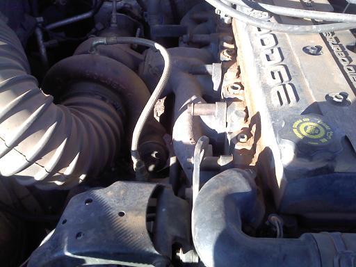

I bought my 02 brand new a week after 9/11. The only mod is an edge ez and a 4" exhause. The heaviest thing Ive ever towed is my 4k lb TT.
The turbo, although not as orange as the one in the above post, is a very light yellowish orange. I drive pretty conservatively, and this truck has never gotten hot. So why would the turbo be discolored ?
The clear coat that they applied to it yellows over time! And I have to asked, did you put your pyro probe pre or post turbo and why? Chris

I believe it is post turbo. I had it installed by "The Power Shop" in enumclaw if you know who they are. I left it up to their discretion. From where it is placed, they said that 1300 is the upper end for safe operation.
That is an interesting post turbo number and would relate to a pre turbo number of around 1550 and melted pistons, if you pulled a long NW grade at those temps. The Power Shop is well noted in the area, so that number from them is quite surprising! Chris
Well then, maybe it is pre turbo :confused: They didnt tell me the location and I didnt look (dont know what I'm looking at anyway). Just for grins, I think Ill give them a call today and ask them just where they would have placed the probe. Yes, they have a very highly regarded reputation which is why I go to them even if it is a long drive from here. Chuck Arnold has forgotten more about diesel than most diesel guys know.
Look at the first picture in this thread and see if you see a similar fitting on the exhaust manifold close to where the turbo is bolted onto the manifold. Chris
Yup, thats where mine is. I thought that would have been considered post turbo. But then, Im not a mechanic. I discovered years ago that if I give someone a little money, magic happens.:)
