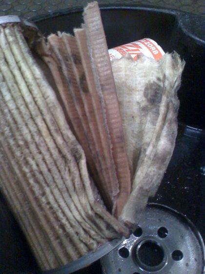

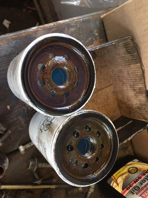

I promise that any water separating filter can fail, the only Filter that will protect 100% and NOT fail is Aqua-Zorb or water encapsulations Filter, ,These filters are NOT legal to install in direct injection system that's why I always state to Install Auxiliary or transfer system or Both.
I've lost count on How many water separating filters I've seen with the cage corroded form the acids in water, either you need to drain/change regularly or risk failure.

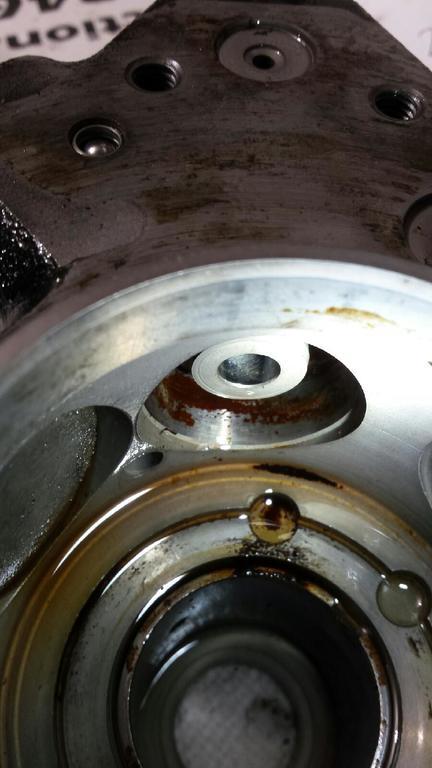

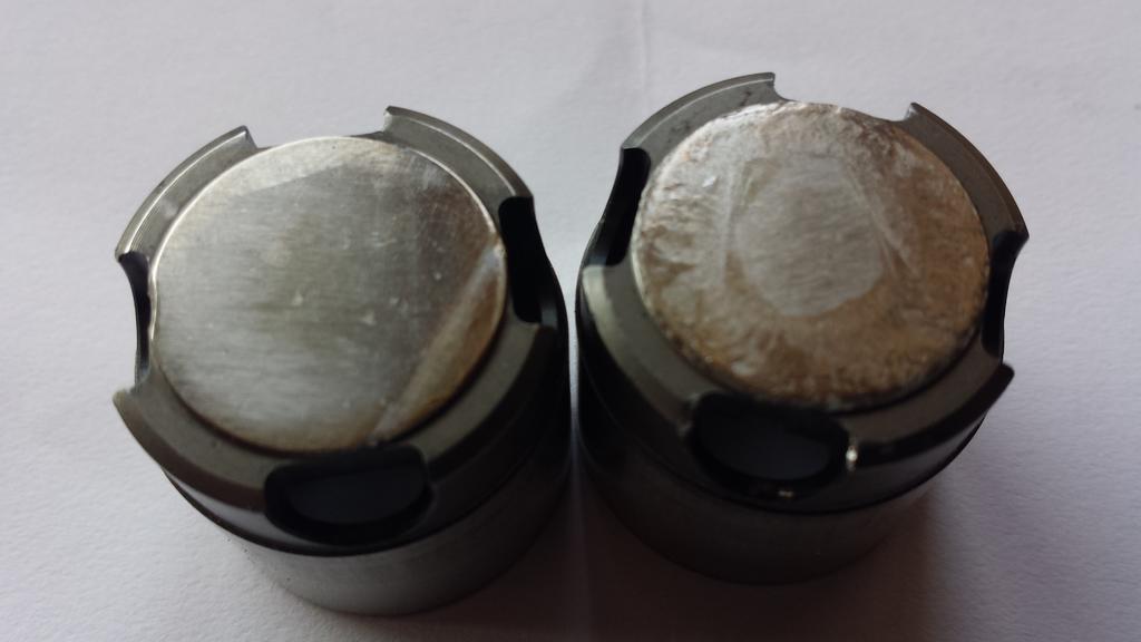

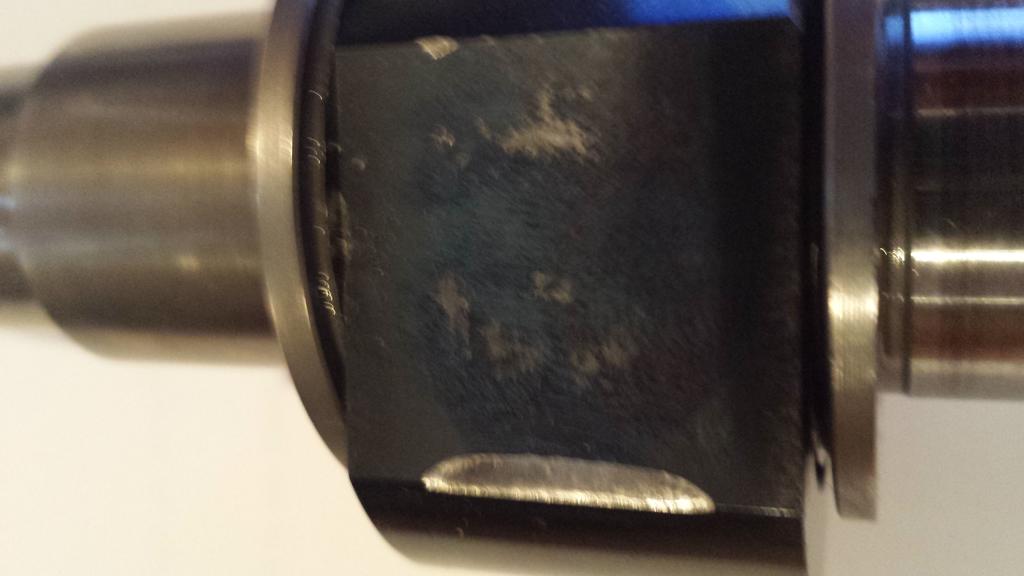

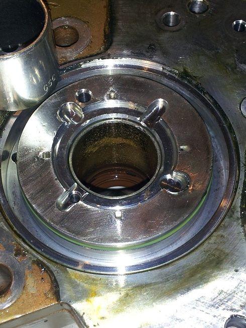

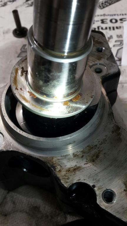

I have been posting this for years, the most popular systems work in most cases but in long term ownership of owning a Diesel that H2o will eventually cost $$$ . You want 100% protection its the only way.
I promise that any water separating filter can fail, the only Filter that will protect 100% and NOT fail is Aqual-Zorb or water encapsulations Filter, ,These filters are NOT legal to install in direct injection system that's why I always state to Install Auxiliary or transfer system or Both.

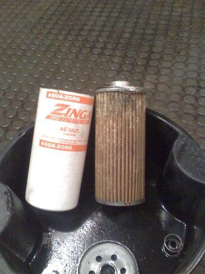

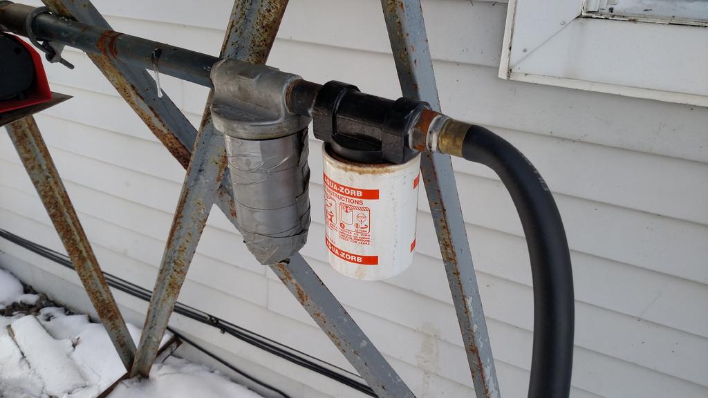

It is what I use on my home tank
Their is NO cage in this filter, It only has steel lids and center section. I have left the steel parts outside in the Junk pile they did not rust.

In the link Nick provided Zinga specifically spells out DO NOT use on internal combustion engines, and proceeds to tell you why. I've seen these filters work first hand. Some years ago when biodiesel first began making it's prescense here my cousin had many equipment related issues. After untold thousands in repairs and downtime over a couple of planting/harvest seasons he got serious about finding adequate filtration and came across the Aqua-Zorb filters. Since installing them on his farm tanks, plumbed two in series per tank (not because Zinga recommended it but because he was so gun shy at the time) he's yet to have any contamination related issues. They work as advertised.
