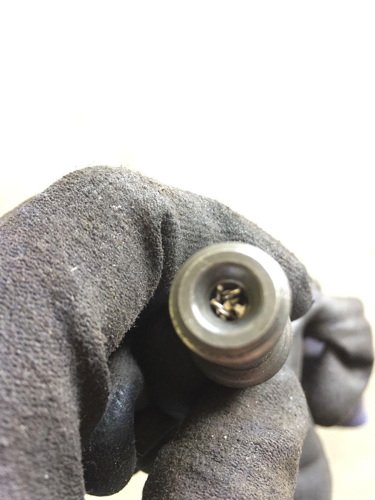

The Edge filters are in the Cross Tubes Not the Injectors.... Much debate over the effectiveness, IMO they do more to cause a swirl effect to stop the forces as the fuel enters the Injector, Also on the 6.7 Rail their is 7 Fuel restrictors, 1 at each inlet fitting.
These restrictors have much to do with the dead Pedal at LOW RPMs, We have sold 3345 Modded 6.7 Rails and each owner will tell you most of the dead Pedal is gone and the engine tone at idle has changed, Same go's for the edge filters remove them and again the tone changes.. We manufacture our own Cross Tubes for Both the 6.7 and 5.9, We Jump in the tube business after all the China Junk tubes being placed even in Bosch Box's. I was done with the imposers, You use our Tubes or reuse The OEM tubes. Warranty Void Form us on the Injectors if Junk tubes are used... I stated this in advance of sale ,I would rather lose the sale then deal with the problems some Tubes create.

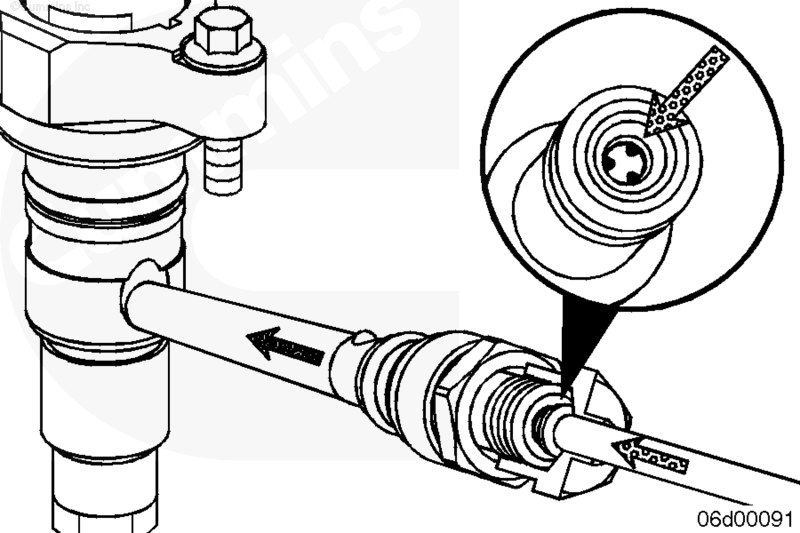

my bad. the edge filters are in the fuel connectors as TC diesel said..
there for a reason. as cummins states. Quote:
The fuel connector contains an edge filter that breaks up small contaminants that enter the fuel system. The edge filter uses pulsating high-pressure to break up any particles so they are small enough to pass through the injector.
Note : The edge filters are not a substitute for cleaning and covering all fuel connections during repair. The edge filters are not a substitute for maintaining the recommended engine mounted fuel filter. quote

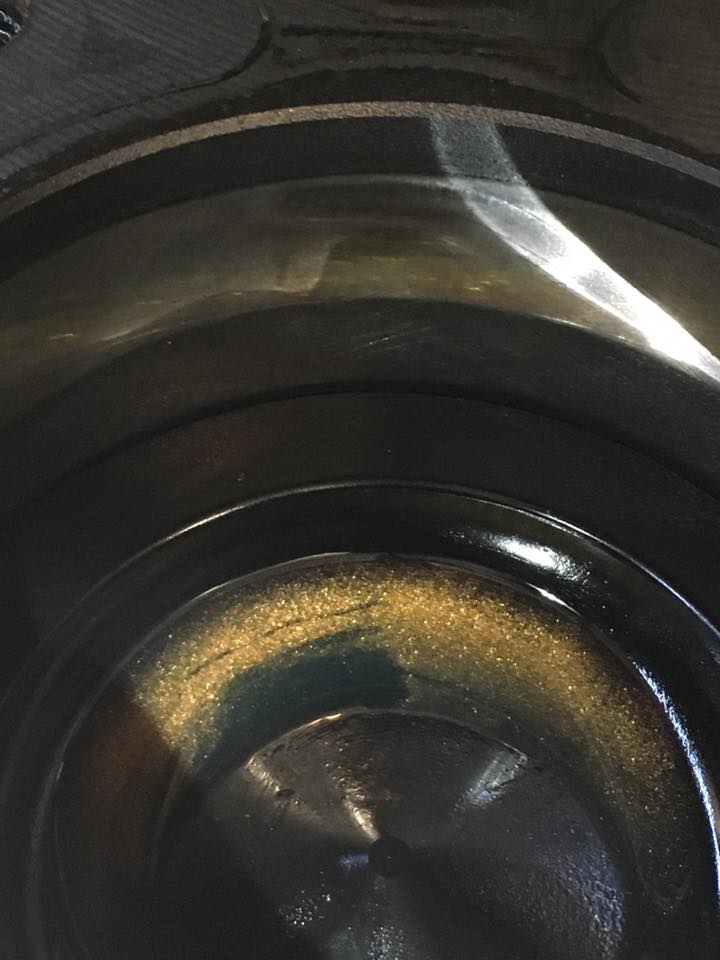

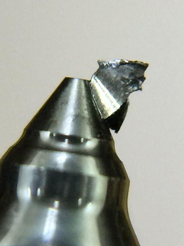

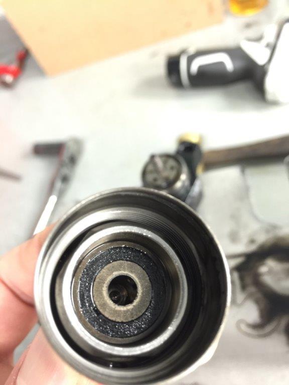

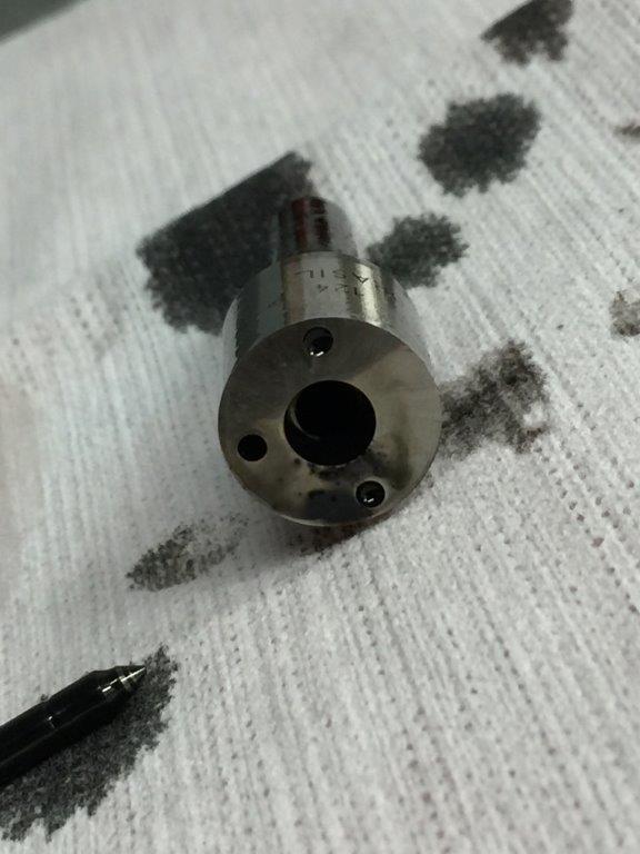

you know, the human eye can't see stuff much smaller than 40 microns.. judging by the debris in those photos I'd say something else happened
